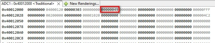

Documentation Error? RM0368 sections 11.12.4 and 11.12.5 list sample A2D clock times for 8 different sample time settings. For all but setting 0, the data seem to disagree with my testing and performance measurements. My measurements indicate:
// SampleTime setting vs Conversion time in A2D Clocks (tested on board NUCLEO-F401RE):
// - CPU Clock = 84 MHz
// - A2D Clock Pre-scaler = 2
// - Three channels per scan (ADC IN0, IN1 & IN4) with DMA transfer ADC to memory.
// 0 => 12.5 + 2.5 = 15 A2D Clocks / convert ( 3M conversions in 1.0714 s) << ONLY real match to general document a 15 clocks = (3 + 12)
// 1 => 12.5 + 10.5 = 23 A2D Clocks / convert ( 3M conversions in 1.6427 s)
// 2 => 12.5 + 19.2 = 31.7 ... ??? very odd (30M conversions in 22.6189s)
// 3 => 12.5 + 28.5 = 41 A2D Clocks / convert (30M conversions in 29.2856s)
// 4 => 12.5 + 56.5 = 69 A2D Clocks / convert (30M conversions in 49.2855s)
// 5 => 12.5 + 75.1 = 87.6 ... ??? very odd (30M conversions in 62.6187s)
// 6 => 12.5 + 96.5 = 109 A2D Clocks / convert (30M conversions in 77.8568s)
// 7 => 12.5 + 320.5 = 333 A2D Clocks / convert (30M conversions in 237.8558s)
You have channel 4 sample rate (SMP4) unchanged. Setting up SMP2 affects channel 2 (IN2).

Interesting that you're measuring less than the expected time, and not more. How are you measuring these durations exactly? I've done the same on STM32F429 (or maybe F405/F411) and they matched the RM exactly. I suspect it's the same ADC module on all of them.
(Note that conversion time is 12 cycles exactly, not 12.5.)

You've changed sampling time for only 2 of the 3 ADC channels, the 3rd remained at 0 i.e. 3 cycles for sampling (or 2.5, depending on which table are you looking at).
March 6, 2024
I think I have all three channels set the same sampling time setting. For example, for setting 1, this is the ADC1->SMPR2 (offset 0x10) register value before the DMA starts and the value is unaltered when it stop. See image:
ADC1 offset 0x10 set to 0x49 (i.e. all three channels are configured for '1')ADC1 offset 0x10 set to 0x49 (i.e. all three channels are configured for '1')
