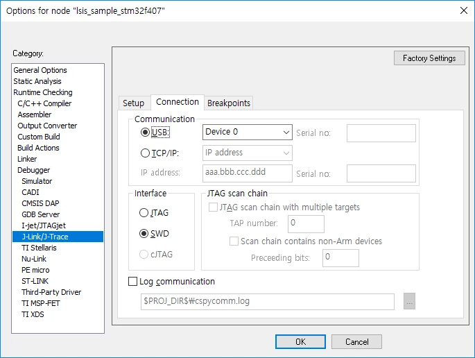

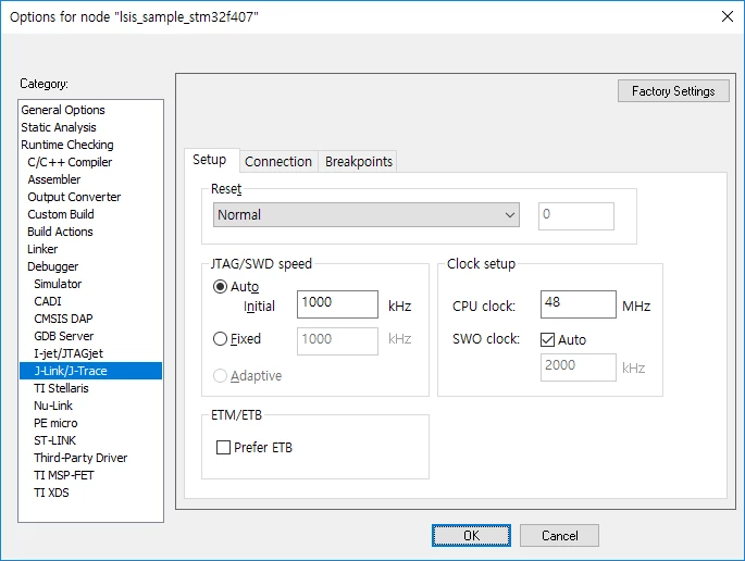

i'm using IAR embedded workbench and stm32f4 discovery board and j-link.
i wanna try download application via SWD (J-Link) connection.

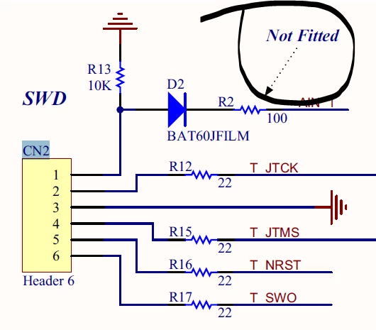

So, first i remove ​CN3 jumper.
and soldering resistor R2.
but still can't download application. (IAR and st-link is successfully operation)
what's wrong ?
my IAR j-link setting is ...
