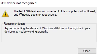

STM32F4 DISC Usb not recognized
I have STM32F4 DISC board and I worked with it several weeks. It was working correctly but today when I was set a SPI connection with other stm32f030 mcu, I plug-in and plug-out usb cable and I got "USB device not recognized" error message.
I didn't change anything.
When I was plug-in, power led on board lighting dimly. Is this a sign for corruption of card??
stm32cude ide can not detect stm32 disc board.
Thanks for any help

Hello again.
I connected external power (5V and GND) to on board pins and board started working correctly.
If I disconnect external GND cable from board and only 5V cable connected on board. Card continued working correctly :flushed_face: . It was interesting
Which component corrupted on board? Any suggestion?
######## edit ########
I found fault on D1 (BAT60JFILM) diode, if I short circuit it board can working.

I restart computer and also uninstall and install driver st-link v2 but. doesn't change anything.
Power Led and LD8 led always on.
I found something : "LD8 (red LED) indicates an over-current from connected device", is this related my issue ?
