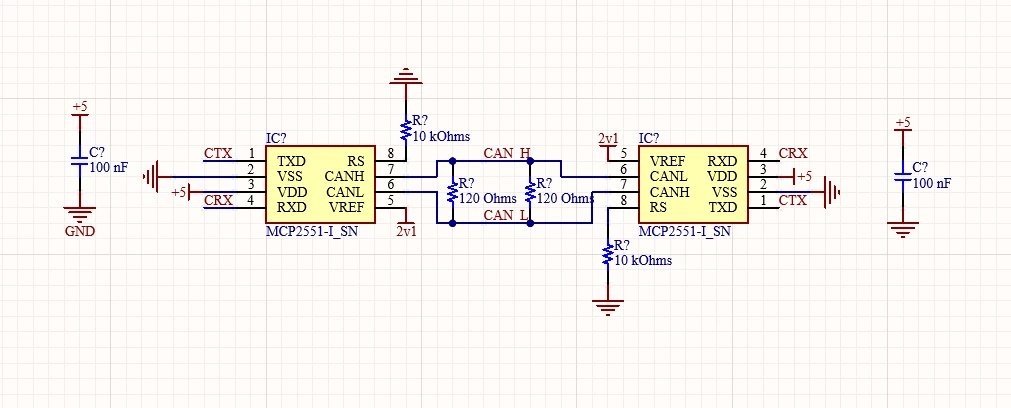

Hello everyone. The last time I opened a form related to bit timing, I realized that the problem was in the Canbus transceiver. I added 1-2 revisions and replaced it with the MCP2551 transceiver. Even though there is a device on the other side, I get an acknowledgment error and the logic analyzer is as follows.

On the CAN bus, connect CANH with CANH, and CANL with CANL.
Then maybe remove one of the 120R resistors.

I found the problem. The message is going to the other party's RX line incorrectly. How can I fix this
Karl Yamashita
Principal
November 14, 2023
Post some code
What do you exactly mean? Some hardware wiring problem?

SergenAuthorBest answer
November 22, 2023
Solution: First, I changed the CAN2 mode to loopback and tried to receive data, but I could not receive it. Then I edited the time segment 1 and 2 values ​​and after receiving the data in loopback mode, I tried normal mode and my system worked.
