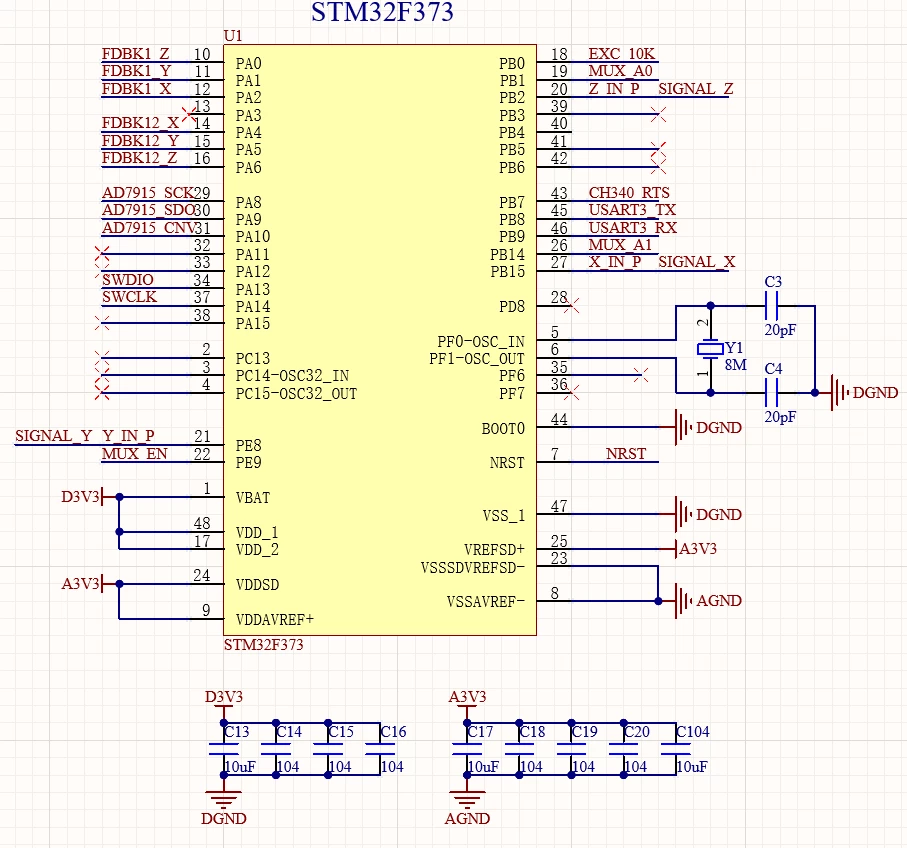

found that the VDDSD pin is in the state of 2.5V during the test, when I removed the stm32f373 from the PCB, the voltage at the pad is 3.3v ,but when I soldered the chip back on, it was about 2.5V again,I would appreciate it if you could help

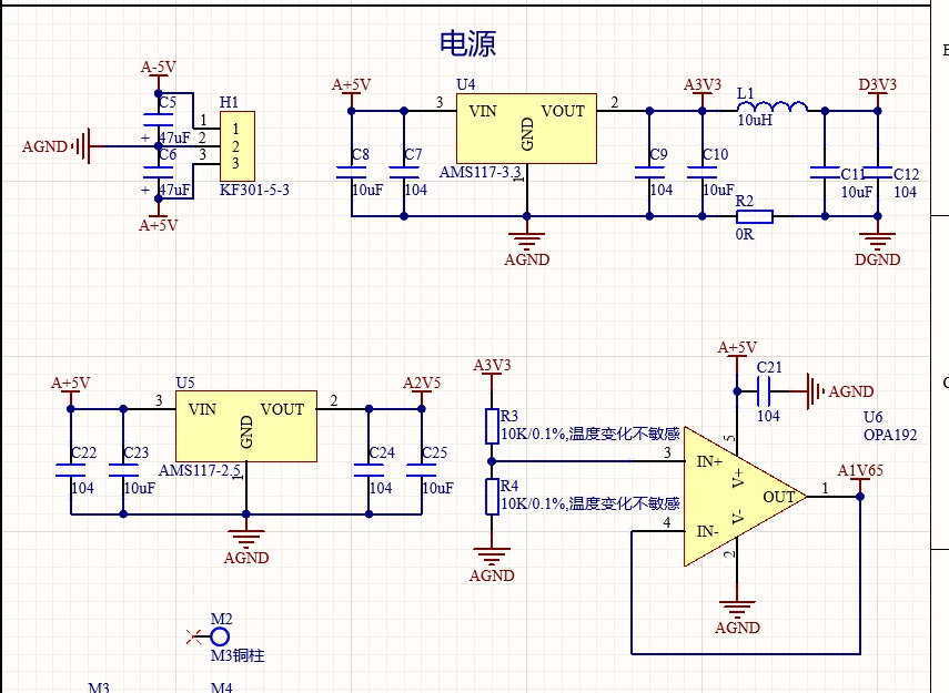

What does your A2V5 Net connect too?
March 6, 2025
Verify part orientation. Pin 1 is bottom left when text is oriented normally.
If that's not it, try shorting R2. Those nets (VSS/VSSA) should be tied directly. Similarly try shorting L1. VDDA should be supplied before or at the same time as VDD.

I swapped the inductance and resistance to 0 ohms, and it still didn't work
March 6, 2025
Can you show a hi res in focus picture of the board?
