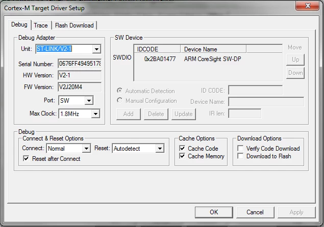

     Here is a visual representation of the issue.
      on my working system, i get:

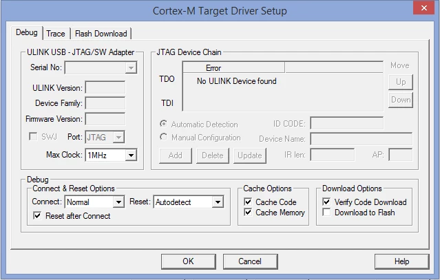

and on the other system, using the same board ( even the same USB cable! ) i get:
Hope that is clearer than my original post.

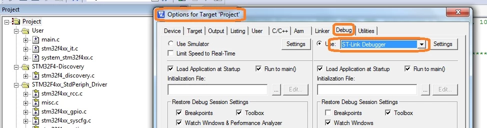

Your post was clear, but the ST-LINK is still not a
U-LINK
, you still need to select the right debugger in the debug pane, then the settings will work.

Do you mean the debug pane shown in the picture above? as you can see, there is nothing listed there at all!
in the first window, it defaulted to the ST-LINK shown. in the 2nd window, it doesnt show anything at all, which seems to be the cause of the problem.
is there somewhere else i need to select this for it to show up here?

Posted on May 26, 2015 at 04:16
You're making this far more complicated than it is. Pick the right debugger and it will find it.
