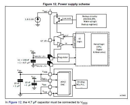

STM32F103RDT6 VDDA PIN
0690X00000BwCEZQA3.png0690X00000BwCEtQAN.pngHi,
In the STM32F103RDT6 , The datsheet showing VDDA pin needs 10nf AND 1Uf. But in AN2586 reference document, it shows 100nf and 1Uf. which one is correct?

waclawek.jan
January 20, 2020
The particular value of 10nF/100nF is not that important. Routing, layout of ground, and placement (as close as possible) of the ceramic capacitors in supply is more important that their particular value.
