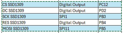

STM32F103RBT6, SPI and I2C conflict
At present I trt o interface an SPI based SSD1309 Display and I2C based DS3231 RTC with STM32F103RBT6 using Nucleo board MB1136 F103RB C. For your reference I have attached screenshot of port assignment for those devices.

When Clock is enabled by “RCC->APB1ENR |= RCC_APB1ENR_I2C1EN;” the SSD1309 is currupted.

Am I missing anything fundametally? I have completed my PCB layouting with these port assignment. Now I am bit nervious.
Please help me to identify the problem.

TDKBest answer
Jul 6, 2026 10:34 PM UTC
Pin PB5 is used by both I2C1 and SPI1 remapped. Thus, the two peripherals cannot be used at the same time if that pin is used. It doesn’t matter that you are not actually using the I2C1_SMBA signal.
This is covered by the note in the datasheet:
 It’s further covered explicitly in the errata:
Chips after STM32F1 have pin selection on a per-pin basis rather than a per-peripheral basis and do not suffer from the limitation. CubeMX handles this correctly, perhaps lay out the pins in there next time (or move to a more recent chip).
Sorry to be the bearer of bad news.

Anesh
AneshAuthor
Jul 11, 2026 10:08 PM UTC
Hi TDK,
Thank you for the quick response. I went through the Errata and understood the problem.
Now I have remapped the pins needed for my communications and did a beasic testing by F103RB Nucelo board.
I request you to check and let me know if there is any issue in this assignment.
Thank you, Best reagrds, Anesh S.
