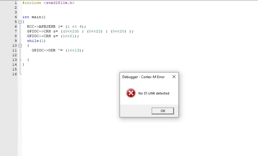

Hi, i tried connecting the board to my pc but it just says that the device is unrecognized. Ive installed the drivers provided by ST but it just doesnt want to connect anyway.
Would anyone know how to rectify this? thanks.

What board? If you mean BluePill, it has no ST-Link onboard - you need to have an external debug interface, like ST Nucleo board with ST-Link. The F103 will not debug itself.

Hi, thank you for your answer, i can debug the blue pill by connecting it with an ST nucelo correct? if so, why does the blue pill have a micro usb?
