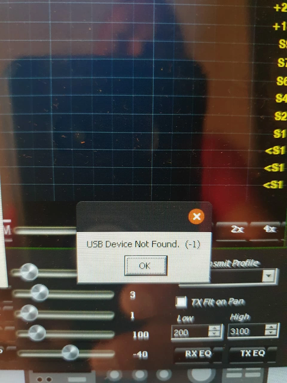

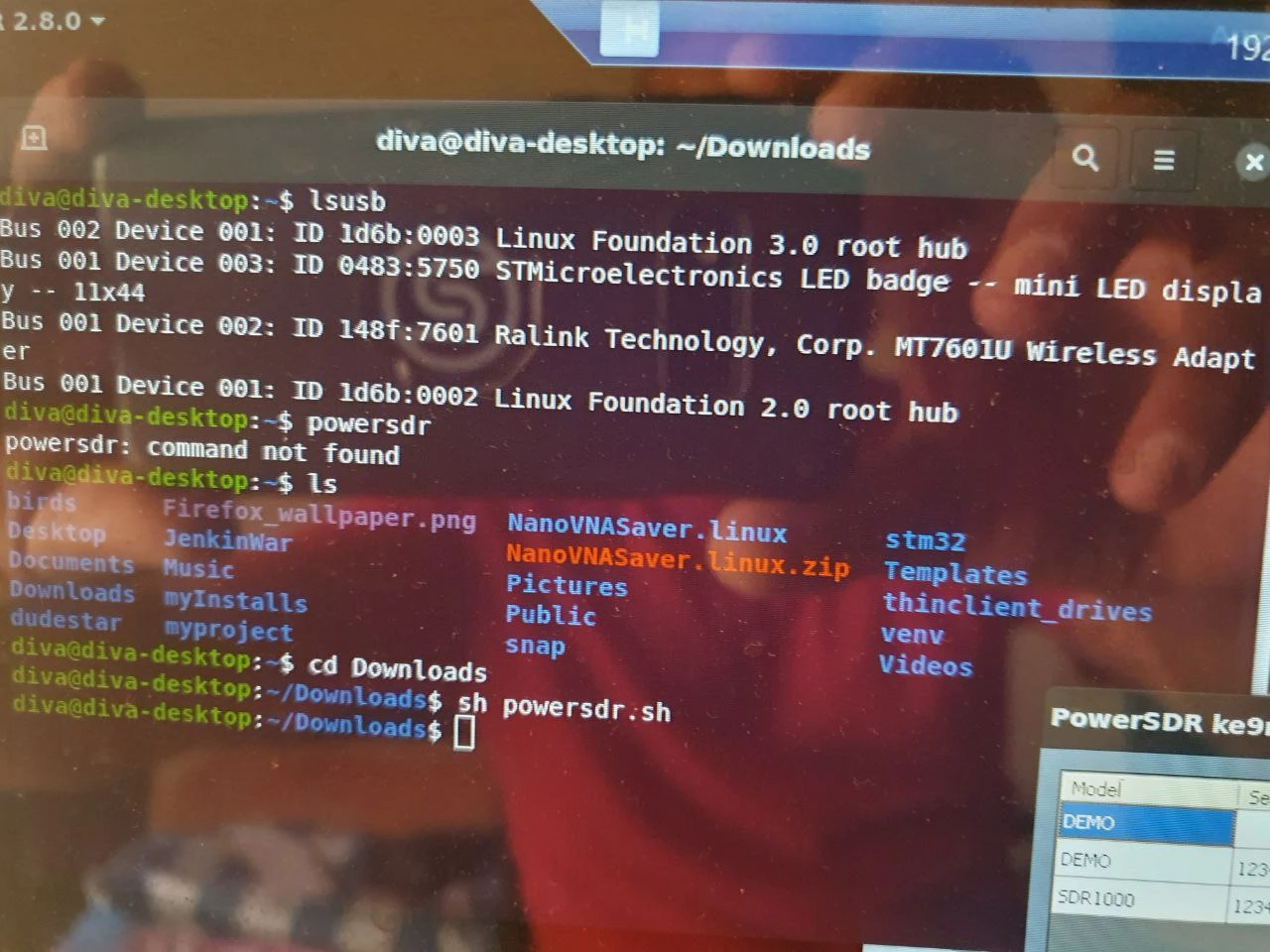

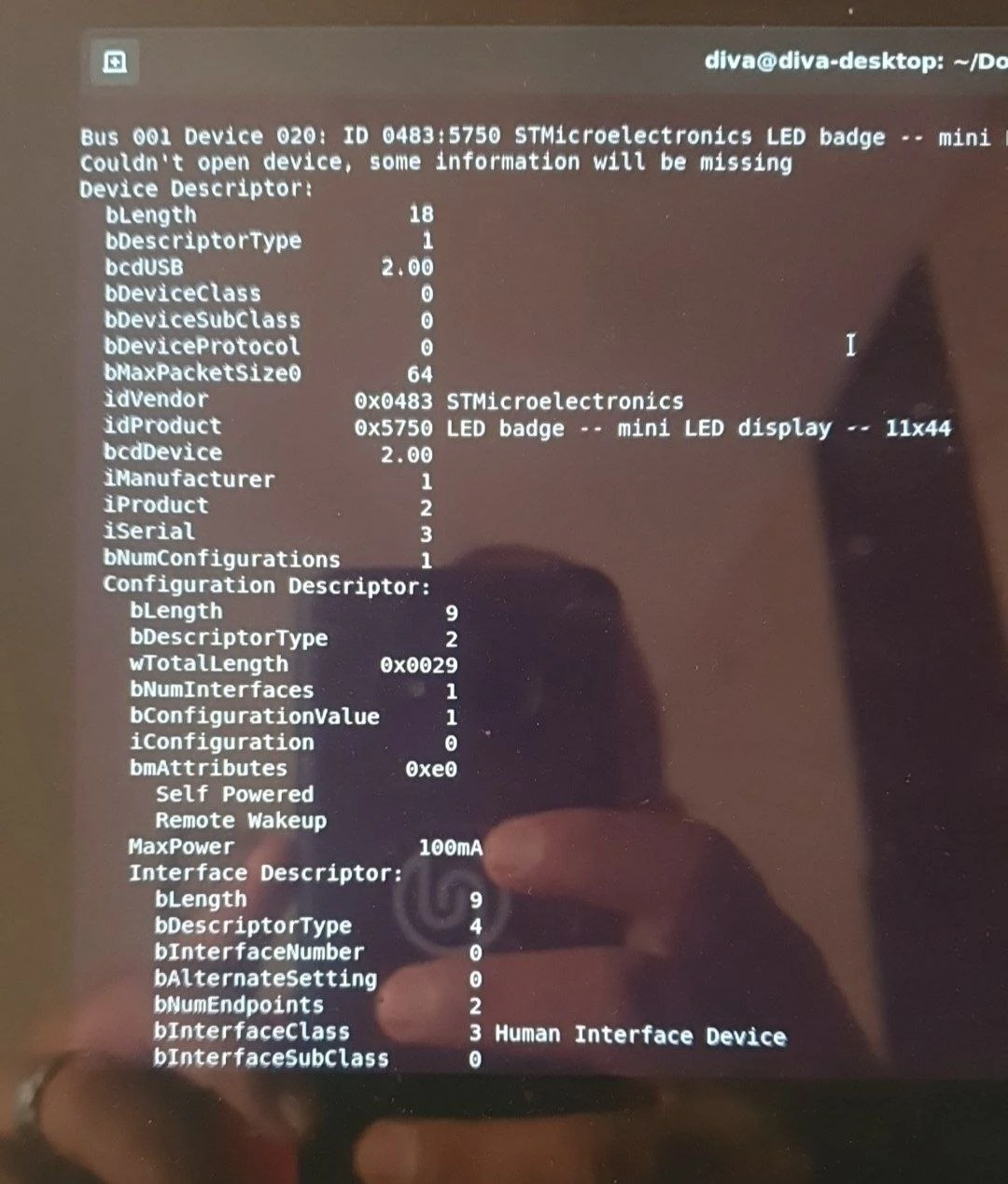

I am trying to get the blue pill detected on Ubuntu desktop , its now detected as LED Display board .
Background
I have flashed the blue pill on windows 64 but and trying to use the Bluepill on Ubuntu through wine , this board will act as the Software Defined Radio and will be plugged into my radio board  and the radio will be controlled by PowerSDR software , this STM32 fixed in my radio board will be connected to the desktop via USB cable and LIne in /out connected to the desktop jacks for data and sound i/o.
https://github.com/stlink-org/stlink used tools for ubuntu from here
Issue
Blue pill detected as LED display board in Ubuntu as its not recognized by PowerSDR.
Pls let me know to resolve this issue and get get it properly detected as it does in windows.
