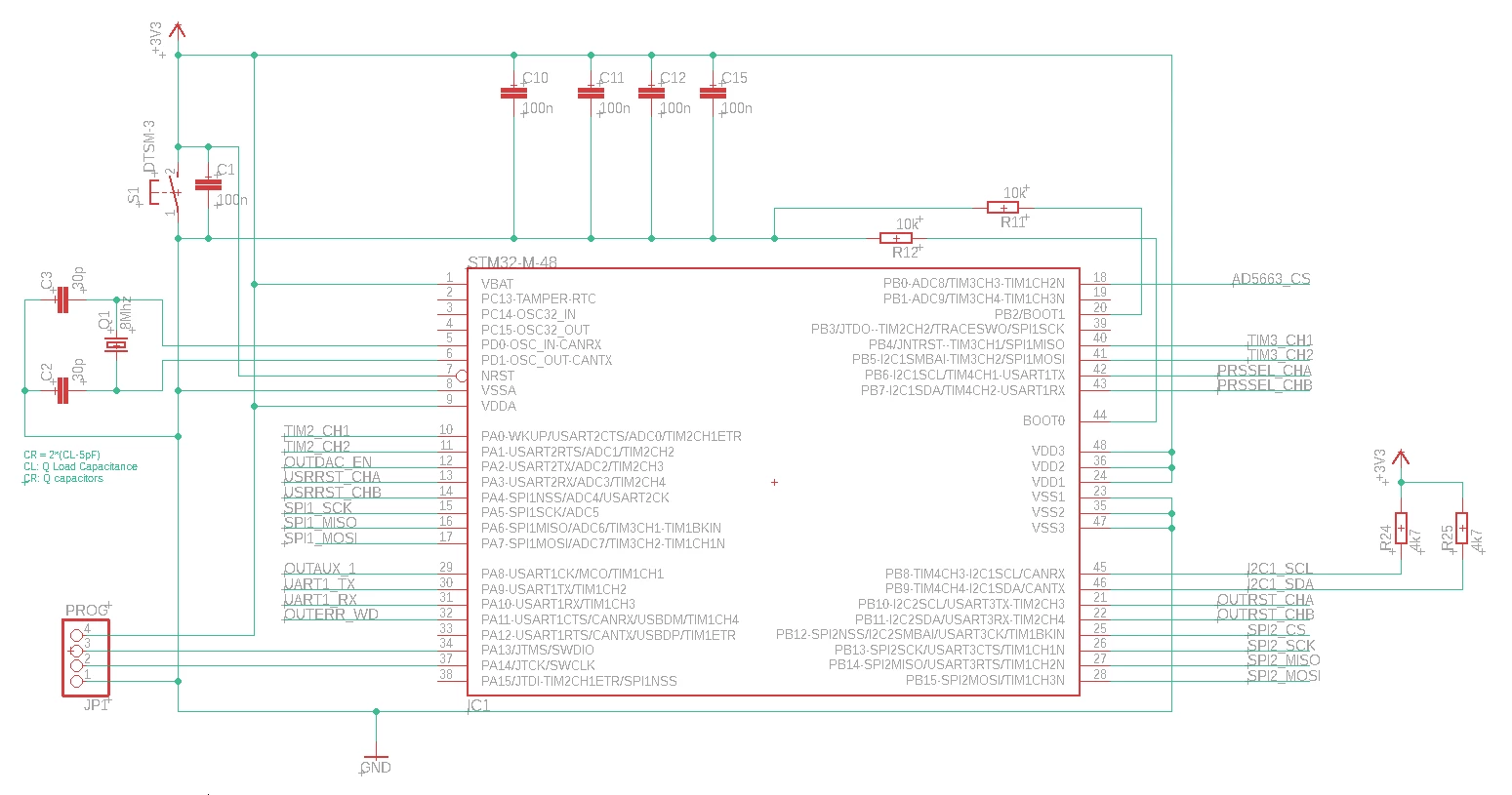

I'm working on a board design with a STM32F103C8. First time for me to build a PCB with STM32, I've always worked with "blue pill" boards.
Not sure about BOOT wiring. The firmware will be uploaded using STM32CubeProgrammer. The board should startup using the internal firmware.
Only HSE External Crystal is used, 8Mhz.
PROG connect is used for programming/debugging.
Can you confirm this design will work? Thanks!

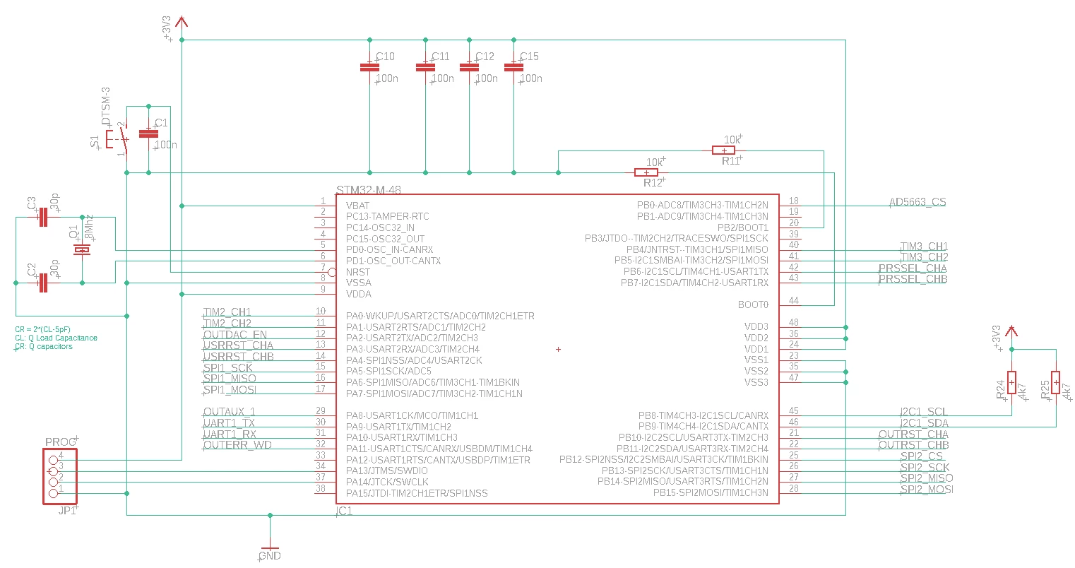

  • C2, C3 seems to be a bit large, check AN2867 for correct values for your crystal
  • R10 should not be necessary
  • add a 100nF capacitor between NRST and GND
  • R9 is also not required
Good luck!

1)
According to AN2867 if I'm right I should apply the 3.3 Load Capacitance formula
Supposing Cs 5pF, which I think is a common value for "standard" PCB, my oscillator should have by datasheet 20pF Load Capacitance, so (Cl1*Cl2)/(Cl1+Cl2)=20pF-5pF and Cl1==Cl2 => Cl1,Cl2=30pF
Does it sound right?
2)
Thank's to you I've look at the datasheet, the NRST already has a RPU resistor, so R9 could be removed
3)
done
4)
I've fond R10 in other schematics, never seen that on my AVR experience, I've to investigate why others (in blue pill for example) use this resistor
@TDK​
Yes, I've a 10uF on the supply sheet.
You are right, readability is not that much with that few VDD and GND points.
Find schematic updated attached

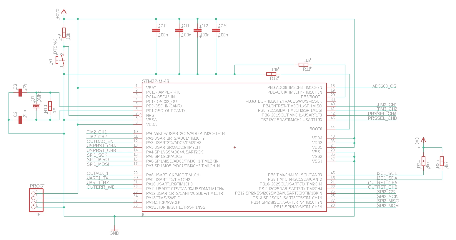

edit:
~ the schematic of this reply is not correct ~
Peter BENSCH
January 14, 2022
Please open the shortcut from NRST to VDD.
lk.dgironi
January 14, 2022
Done below

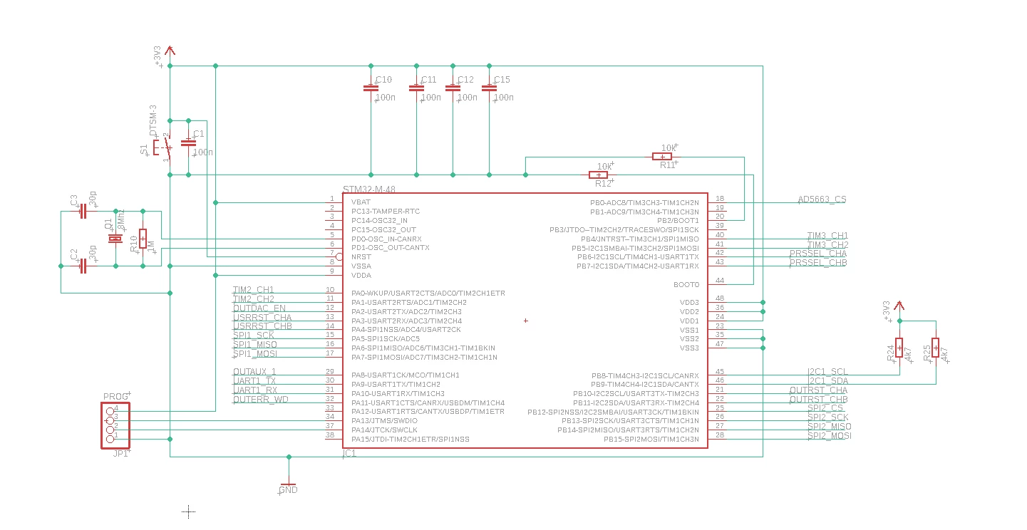

lk.dgironi
lk.dgironiAuthorBest answer
January 14, 2022
Solved.
Schematic attached.
Peter BENSCH
January 14, 2022
Now it looks ok.
Regards
/Peter
