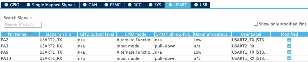

STM32F103 UART interrupt not working
Hello, I'm building a project where I will use CAN, UART and a TIMER. All of these work with an interrupt. How it works: I get data via CAN and use a TIMER to send a Request on the CANbus. With the UART I need to receive some commands that will trigger some functions. I have provided my code. In this code everything is working except for the UART interrupt. I had a different project with UART where everything was in the main, so I copied that to see if that is working, but it doesn't work. The UART interrupt is not getting triggered, but in the separate project it is working where I only use UART. What is wrong?

SmdeintBest answer
January 23, 2024
I got it working. I didn't look at the PIN settings. The receive pin (PA3) of USART2 was set to GPIO mode, but it should be input mode. afbeelding 2024-01-23 at 13.18.26 (2).png

mƎALLEm
January 23, 2024
Did you activate the interrupt for the UART? (check if the NVIC interrupt line for your UART is configured).
SmdeintAuthor
January 23, 2024
Yes, I activated the interrupt for UART, CAN, TIMER.
mƎALLEm
January 23, 2024
Try to isolate UART functions and built a simple application with only UART and see if the issue still happen.
