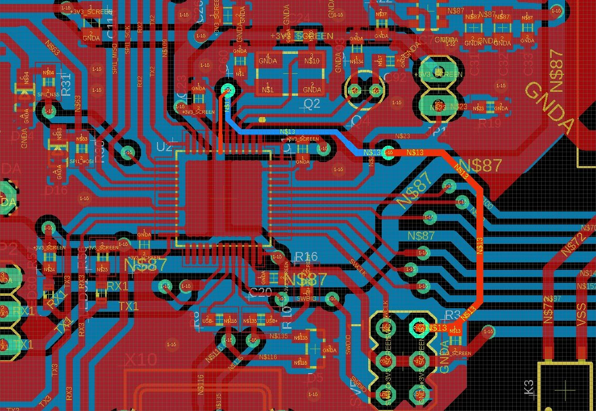

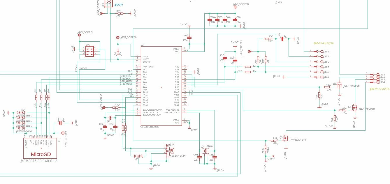

STM32F103 random reset
Hello, we have made a 2 layer board for a STM32f103, and apparently it works fine but we get a random resets now and then. When that occurs there is a 1 in the Bit 27 PORRSTF: POR/PDR reset flag and Bit 26 PINRSTF: PIN reset flag of the Control/status register (RCC_CSR). I think it might be some kind of noise on that trace? Attached is a picture of that portion of the PCB and SCH, with the RESET trace highlighted.
Any ideas of what could be the error?0693W000001syI7QAI.jpg0693W000001syICQAY.jpg

All reference designs have NRST bypassed to GND with a 0.1uF capacitor to prevent spurious resets. Yours doesn't have a cap at all. I would suggest adding that to see if it fixes the problem.
