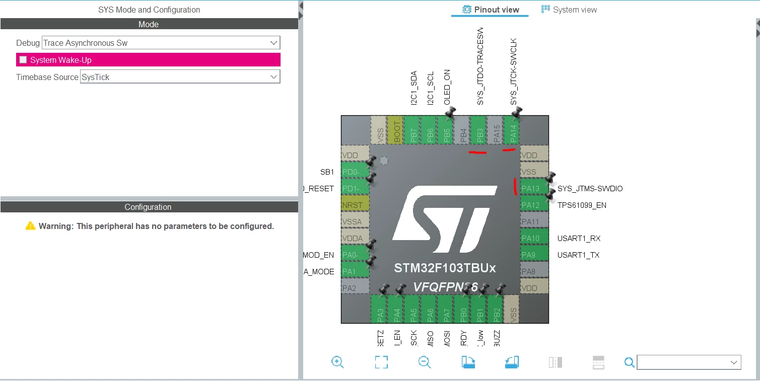

0693W00000WLIjiQAH.pngI turn on Trace Async Sw:

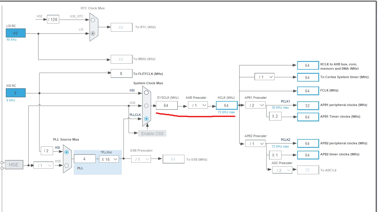

0693W00000WLIkbQAH.pngMy clock:

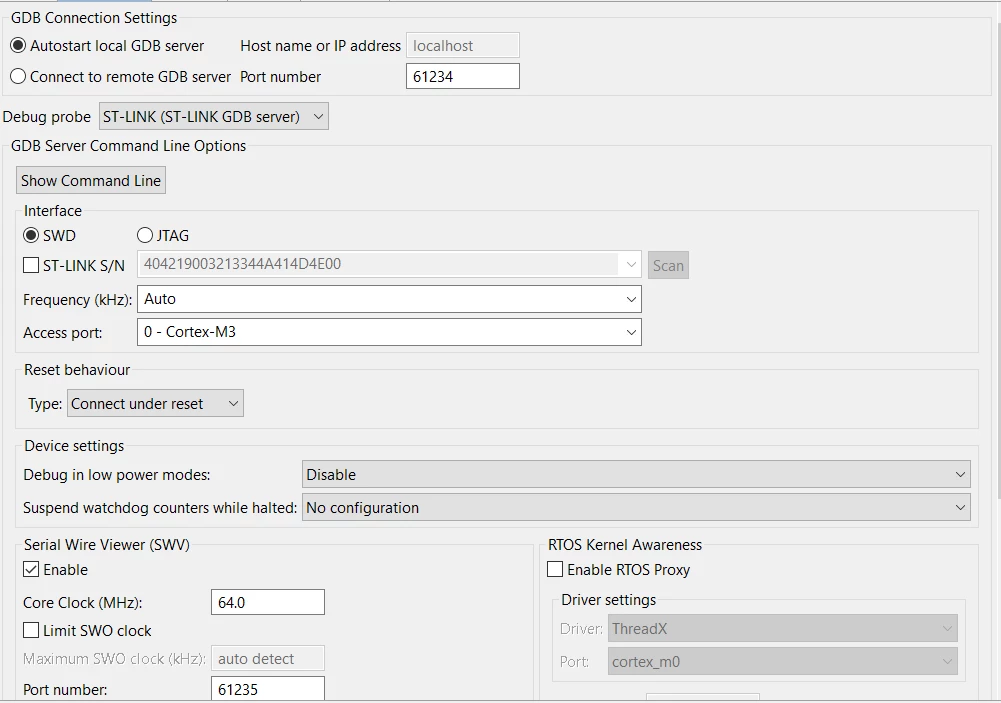

Setting up debug:
0693W00000WLIkXQAX.pngStart debug:

Now SWV:
0693W00000WLInpQAH.pngPressing "Start Trace" and resume code.
And I see nothing in SWV tabs =(
What wrong in my program?

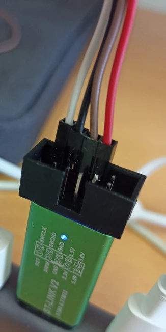

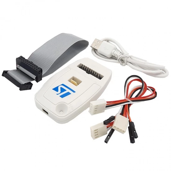

This programmer should be enough for SWV trace? I can't find some more info about it :p0693W00000Y6s1GQAR.jpg
AScha.3
December 26, 2022
if you can solder a thin wire - just mod your old stlinkV2 :
https://lujji.github.io/blog/stlink-clone-trace/
works fine.
here statistics:
EBurk.1
EBurk.1Author
December 26, 2022
Yes, I will do it. But I need "plan b" if it wont work as well. As I understand in ST-Link as shown upper have SWO and JNRST pins, right? And I can use it for SWV Data Trace...
