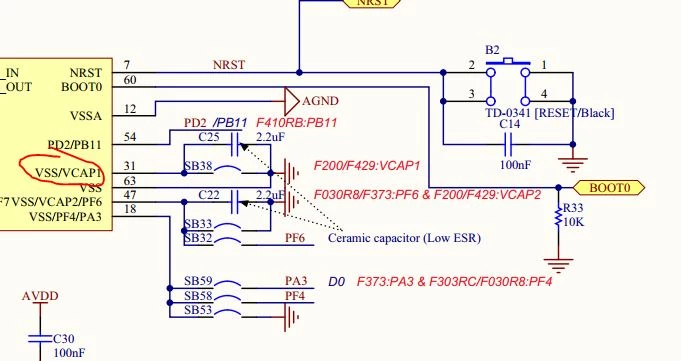

Ssona.1
Ssona.1Author
June 22, 2020
Is there any VCAP required for this IC ?
Please provide your comment.
