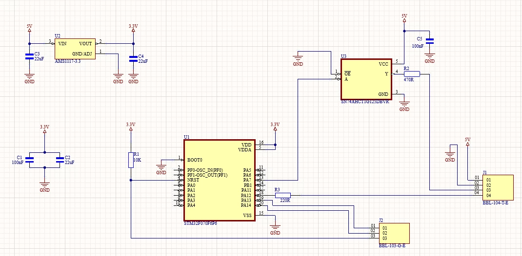

I have recently ordered my custom board from JLCPCB with STM32F070F6P6. When the board arrived to me, I tried to connect the CPU to ST-LINK V2, but it would not connect. I have checked all the connections on the board and everything seems to be good. I have also checked the voltage with an oscilloscope, and again it seems to be good - the voltage is stable 3.3V. I have completely no idea why it can not connect to ST-LINK. I am attaching below the picture of the schematic of my board. I am connecting SWDIO (PA13) and SWCLK (PA14) via J2 01 and 02 pins. The power comes from ST-LINK (3.3V from the voltage regulator). I tried with and without RESET and nothing changed. Am I doing something wrong?

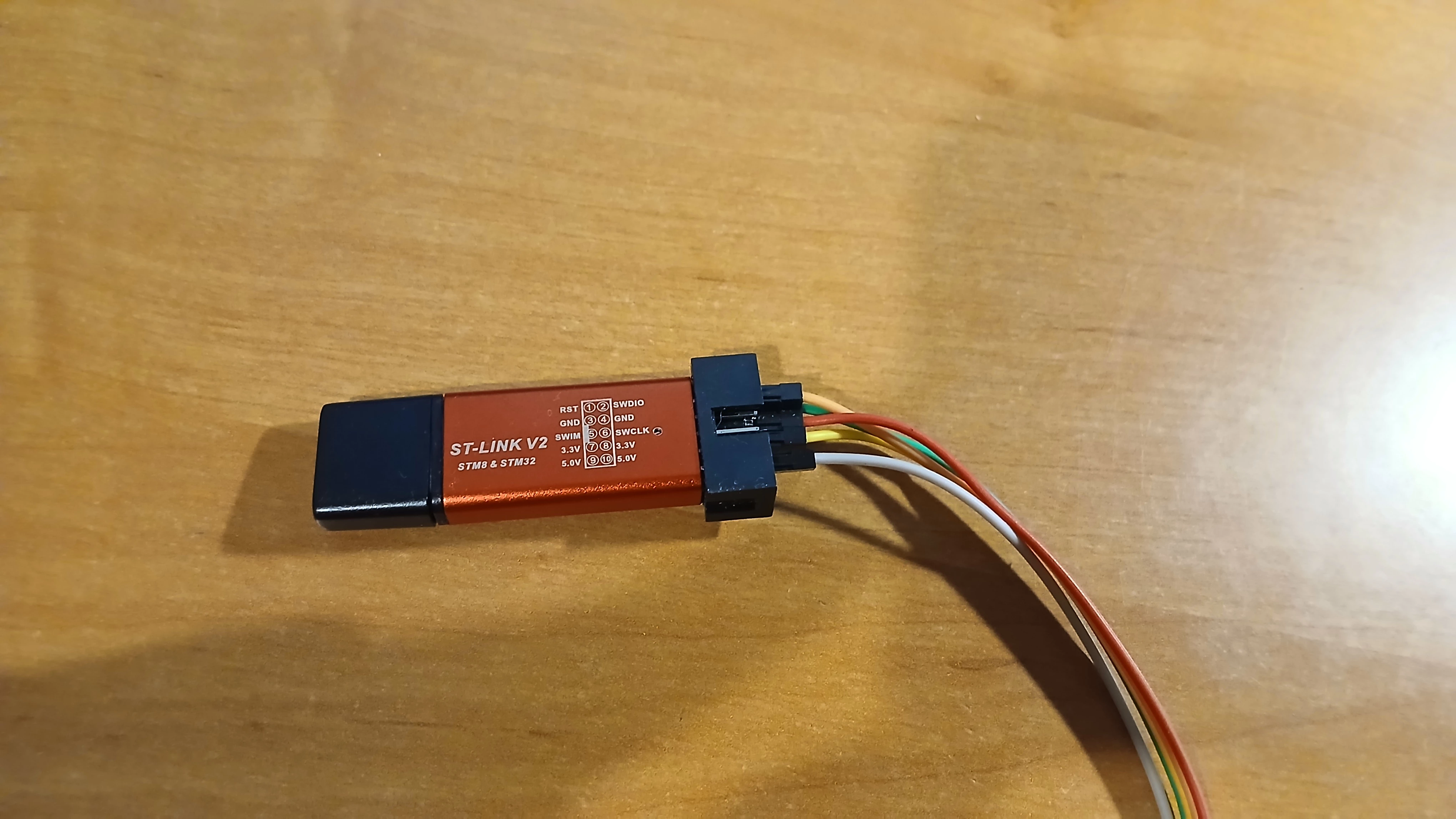

In addition to the request of @STTwo-32: the original ST-LINK/V2 do not output a voltage of 3.3V to supply a target, but only check whether the target voltage is correct.
But first of all, to assess your problem, you need the image of at least the back of the ST-LINK/V2.

The 3.3V needs to go to Pin 1 or 2 (VTarget) of the ST-LINK/V2 20-pin Header
This is in addition to the SWDIO, SWCLK, and GND you have from your header
STM32 Cube Programmer should be reporting this 3.3V being present.
If you have a counterfeit ST-LINK (gum stick), then ST is unlikely to support.
The NRST pin needs to be connected for "Connect Under Reset" to be viable.

NRST is poorly connected. See for reference schematics:
AN4325
Application note
Getting started with STM32F030xx and STM32F070xx series hardware development
hth

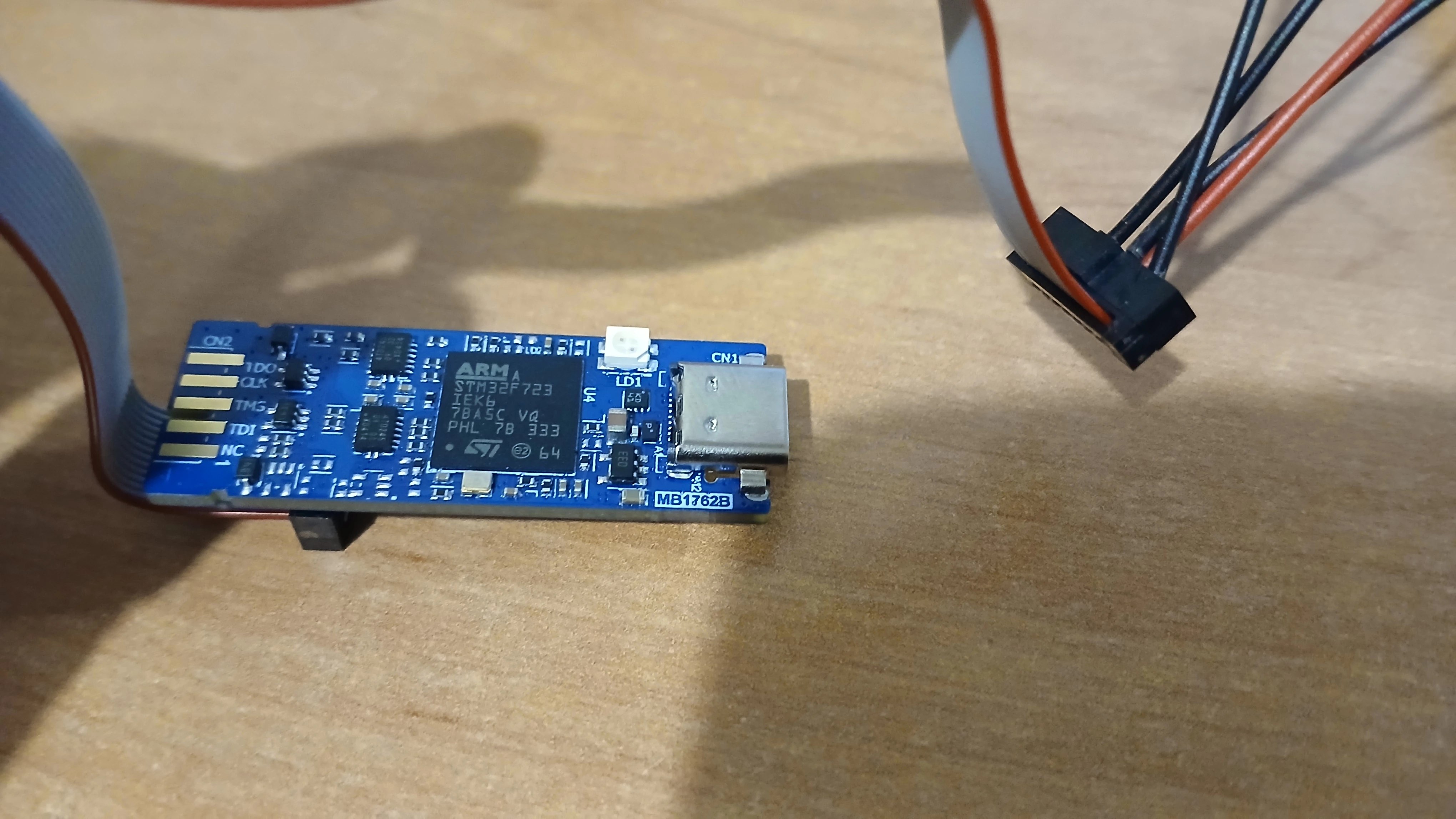

Here is my ST-LINK V2 (the first picture), but I guess it is a counterfeit ST-LINK, but according to that I ordered a new ST-LINK. It is STLINK-V3MINIE (the second picture) and this is the original one. I connected that in the same way, and I am facing the same issue. The microcontroller on my board connected via STLINK-V3MINIE is not responding. It is really strange, because I have another board from my previous project, where I have a very similar circuit and there is STM32F030F4P6 and there everything is good - the microcontroller responds via these STLINKs. The only idea that I have for now is that the ICs were somehow damaged during an assembly in JLCPCB, but I am not sure about that.
That's probably harder than you'd imagine. More likely a board or electrical issue. Double check orientation and wiring
Perhaps a high resolution, large, in-focus, picture of the board. Show connectivity with ST-LINK

Sorry for the late response. After many re-checks of almost everything that could cause the problem, I have finally solved it. As @Tesla DeLorean mentioned, it was an electrical issue. I made a very *** connection. It was due to too long and too weak wires between my PCB and ST-LINK. I used shorter wires. The second reason was that counterfeit ST-LINK was disconnecting at totally random moments. Now I know that buying any counterfeits is a bad idea.
