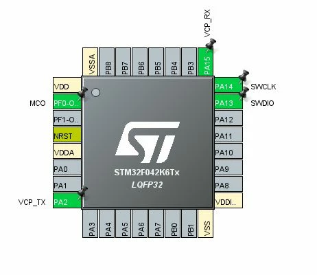

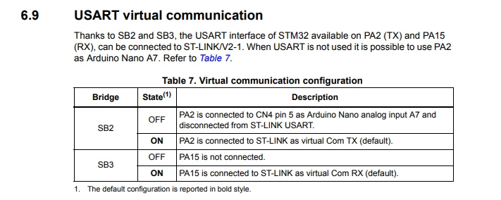

By default, cubeMX assigns USART2 Tx and Rx to PA2 and PA3. According to the STM32 manual, for virtual communication (USB), only PA2 and PA15 are used. I had to change PA3 to PA15. Now the program works.

You've mentioned solder bridges, so does that mean you have a Nucleo-F042K6?
You haven't mentioned what is connected to uart1 and uart2?
If a reply has proven helpful, click on Accept as Solution so that it'll show at top of the post.CAN Jammer an open source CAN bus hacking toolCANableV3 Open Source
bongumsa12AuthorBest answer
October 20, 2023
Karl Yamashita
Principal
October 20, 2023
When you start a new Nucleo-F042K6 board project it configures VCP correctly. You ended up creating a new project for just a STM32F042 which defaults to PA2 and PA3.
