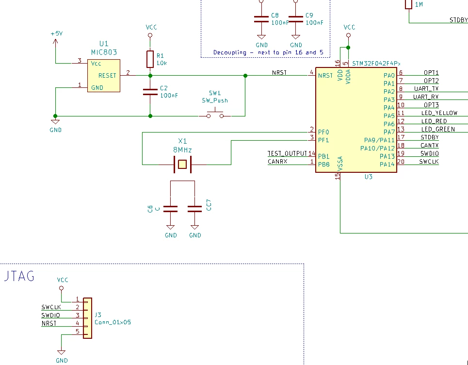

I am bringing up a small test board containing a STM32F042 MCU with just several connections.
I have exported code from CubeMX5 and imported into Eclipse. I am trying to debug the board with j-link but according to debugger code loops infinitely somewhere from 0x1fff c6e0 to 0x1fff c9f0. The code never stops unless I suspend it and that is where the debugger always land with message: Break at address "0x1fffc6e0" with no debug information available, or outside of program code. Im not sure is this the startup code.

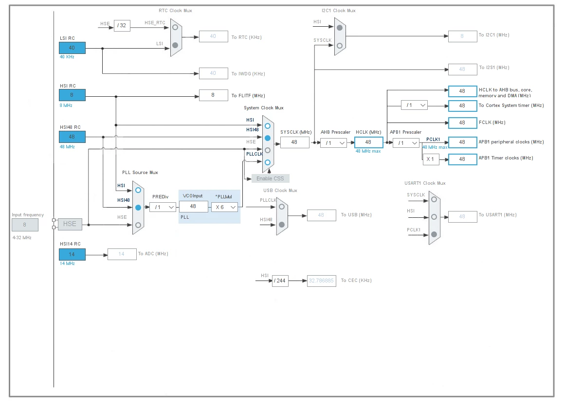

Below are the images showing how is the MCU connected and the clock setup. When I first connected the board it seemed to be working and entered the main() but but I had to reset the j-link on every start. Now I cannot get it to work even with completely freshly generated project from CubeMX. Debugger always lands in that part of code.
I pasted relevant part of my schematic and the clock configuration diagram below.
Does anyone has any idea how to debug this?

If there is no boot pin, you need to make sure the boot options are set to execute code in FLASH
Perhaps use the ST-LINK Utilites, or equivalent Segger tools to check.

Thanks for that idea. It seems to me that I boot from system memory. I did not see the boot pin in the CubeMX so I just thought that I don't have one.

I struggled to change the option bytes on the jlink or directly from Eclipse. I failed so installed ST-LINK on a windows virtual machine bcause I develop on Linux. I do not have ST-LINK hardware here so I used Nucleo board ST-LINK part and ST-LINK utility in windows to change the option bytes from graphical user interface, saved it and the board booted normally into the main().
So it was finally because of the option bytes.
