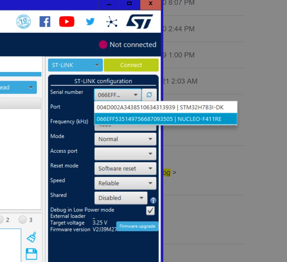

Pushing the refresh button with ST_LINK Selected produces:
 10:46:41 : ST-LINK error (DEV_CONNECT_ERR)
However the drop down control shows both the devices that are connected viz:
Pushing the Connect button for the Nucleo produces an error:

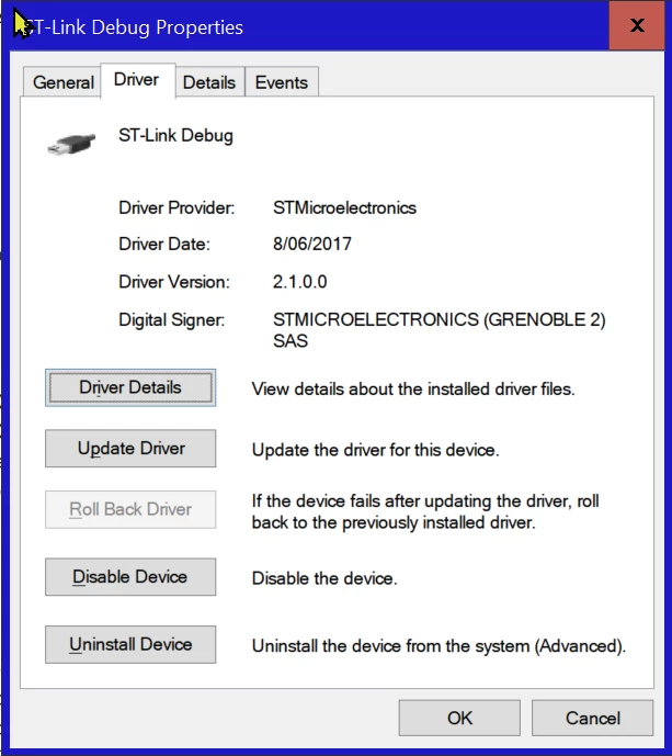

The driver details are:

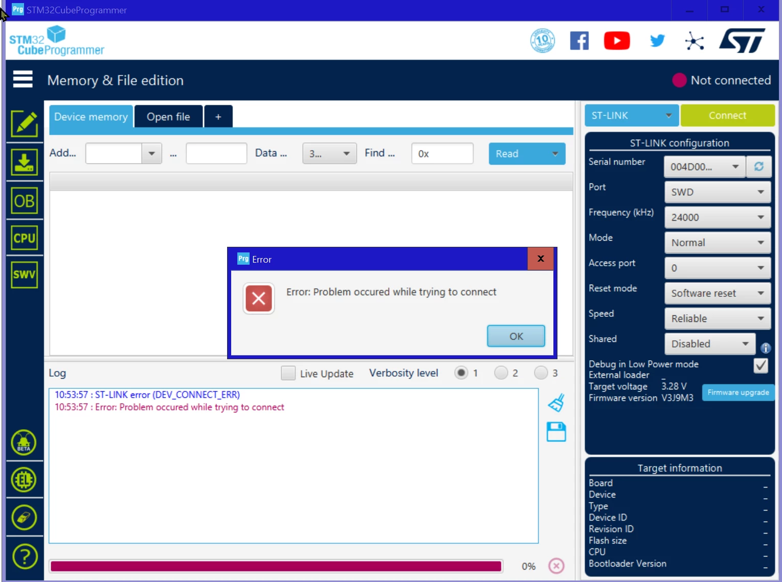

I tried setting it to 0, but I still get the same error. I then tried it on 1 and 2 but got the same result:
0693W00000KdF9aQAF.pngI thought that maybe my anti-virus programs had quarantined a .dll file or something so I turned the anti-virus programs off then uninstalled Programmer then reinstalled it.
I kept the antivirus programs off throughout the test.
I ran it as Admin and tried it on a Nucleo F411RE and the Discovery board STM32H7B3LI-DK. Didn't work.

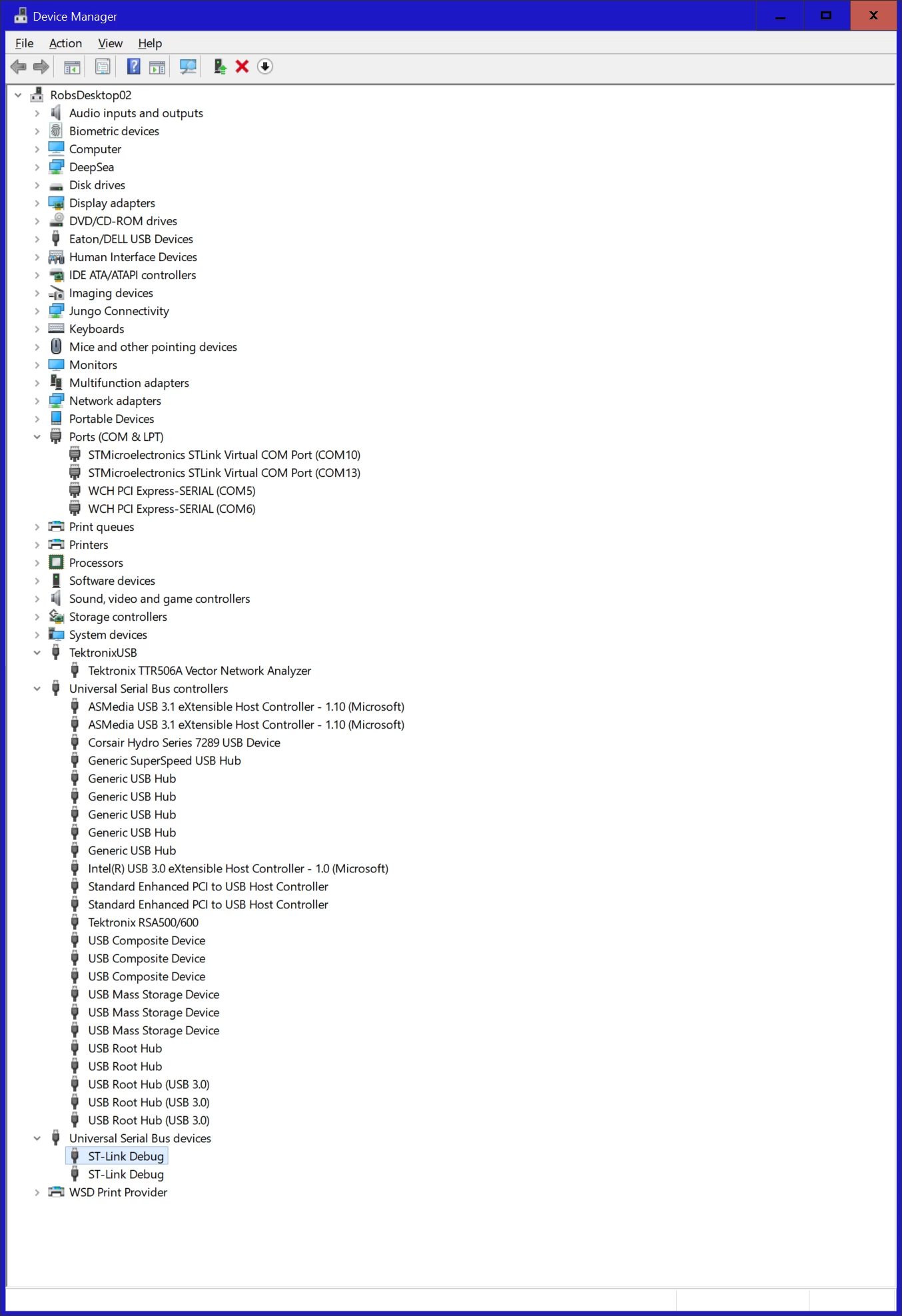

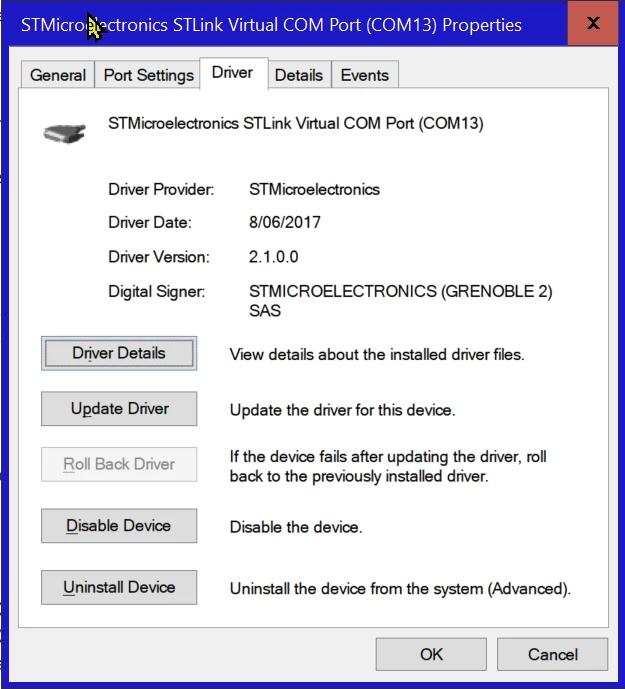

Here is a screenshot of my desktop device manager showing the various ST Drivers. Two are shown, one is for STMStudio monitoring another project and the other is the Disco I'm testing Programmer on. I also ran Deployment Imaging service and SFC also shown below.
SFC picked up some errors so to ensure SFC had repaired them I ran it again and it found no issues.
I then tried it with the STMStudio usb removed so that on the test board was connected and et voila it works. I connected two disco's up ant that worked to, so it looks like STMStudio isn't behaving correctly.

Mike_ST
March 16, 2022
You've got a blank value for the Access Port.
Please set it to 0.
