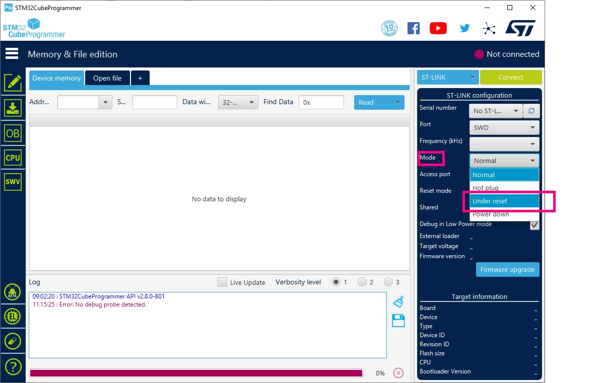

Houda GHABRI
June 21, 2021
Hi @FSkro.1​ ,
Can you please try to connect under reset and tell me if it is Ok?
Houda

Under reset or in power down mode I get the following:
 09:06:08 : ST-LINK SN : 0035002E3438510534313939
 09:06:08 : ST-LINK FW : V3J7M2
 09:06:08 : Board : STM32H7B3I-DK
 09:06:08 : Voltage : 3.28V
 09:06:09 : ST-LINK error (DEV_CONNECT_ERR)
 09:06:09 : ST-LINK SN : 0035002E3438510534313939
 09:06:09 : ST-LINK FW : V3J7M2
 09:06:09 : Board : STM32H7B3I-DK
 09:06:09 : Voltage : 3.28V
 09:06:10 : Error: ST-LINK error (DEV_CONNECT_ERR)
