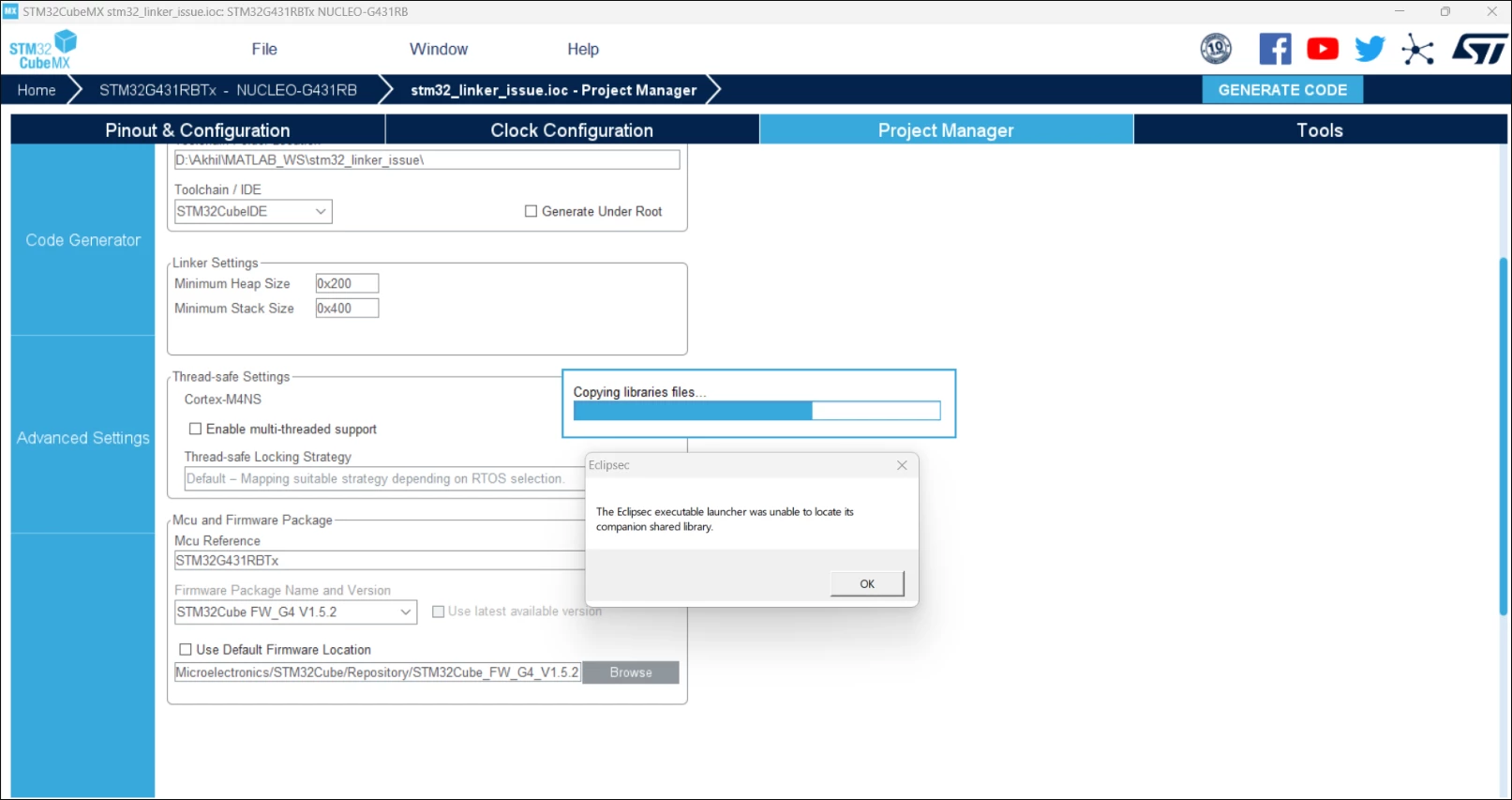

When I try to generate code from stm32cubemx v6.4.0. I'm getting an error message like "The Eclipsec execution launcher was unable to locate its companion share library.". I'm attaching the screen shot here
How to resolve this issue
Thanks,
Akhil

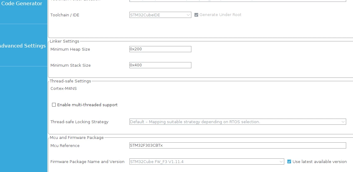

you changed settings for code.gen. ? ( + gen. under root , set it.)
see mine:

Yes, I changed the settings as I followed the instructions provided on the MathWorks website. You can find the relevant instructions here: Getting Started with STM32CubeMX.
Let me know if you need any more details.

Try my setting... + gen. under root , set it.
