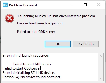

STM32CubeIDE, STM32U5 : unable to launch the debugger (gdbserver)
Impossible to launch the debugger with the following configuration:
  • STM32CubeIde1.7.0
  • Target Nucleo-U575ZI-Q
  • ST-link :
  1. Version: V3J8M3
  2. Build:  Apr 9 2021 20:49:40
See log files
STm32cubeProg 2.8.1 can connect to the board successfully.
What is wrong ?
BUG ?

Javier1
Principal
November 2, 2021
maybe you didnt closed the STM32CubeProg session so the gdb server is busy? it happens to me sometimes

0693W00000GWFHpQAP.pngI admit that I have also made this mistake more than once, but not in this case.

LaurentL
November 2, 2021
Can you try to decrease the STLink SWD frequency.
If not better, can you try with OpenOcd gdb server.
Rgds,
Laurent

MFred.2
MFred.2Author
November 5, 2021
Indeed, decreasing the frequency of the St-link seems to improve the connection, but it is not very stable.
The frequency of successful connection varies between 8Mhz and 21Mhz !
I have not encountered this problem on other Nucleo board references.
Regards

mattias norlander
November 5, 2021
Stay below the 8MHz as specified in the errata: https://wiki.st.com/stm32mcu/wiki/STM32CubeIDE:STM32CubeIDE_errata_1.7.0#STM32U5
The lower the better stability.

MFred.2
MFred.2Author
November 5, 2021
thank you for this information,
This problem is therefore already known
I didn't think about reading this errata sheet, sorry
