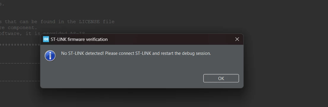

STM32CubeIDE shows "NO ST-LINK DETECTED."
  • October 17, 2024
  • 3 replies
  • 2989 views

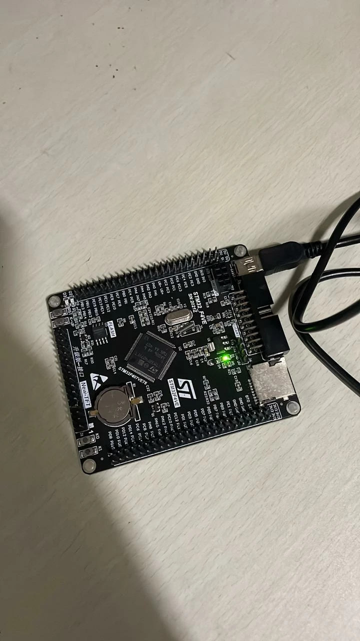

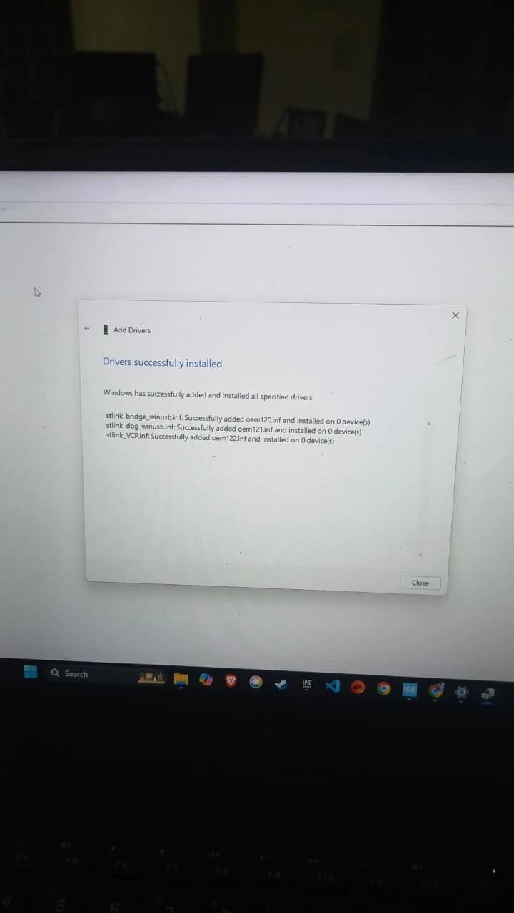

Screenshot 2024-10-17 181446.pngWhatsApp Image 2024-10-17 at 6.14.52 PM.jpegWhatsApp Image 2024-10-17 at 6.35.11 PM.jpegWe're using the STM32F407VET6 microcontroller. When I connect it to my Windows laptop and attempt to debug with STM32CubeIDE, it shows "NO ST-LINK DETECTED, CONNECT AND RESTART DEBUGGING." I’m unsure how to resolve this issue. The user manual states it has a built-in debugger, but CubeIDE isn’t recognizing it. We need help, as this is crucial for our final year engineering project.

What board is that? It doesn't look like a genuine ST board.

If it is supposed to have an ST-Link, does Windows detect it?
https://community.st.com/t5/stm32-mcus/how-to-solve-debugger-connection-issues/tac-p/698105/highlight/true#M956
But that doesn't seem to be true from the photo.
Perhaps they (and/or you) are confusing the internal debug features within the STM32 chip with the external hardware (eg, ST-Link) needed to access those features from tools like CubeIDE?
Please provide a link to this User Manual - and the other board details.
It looks like one of these:
https://www.aliexpress.com/item/1005007550369339.html
https://www.aliexpress.com/item/1005001593938285.html
So definitely not an ST board - and it has no ST-Link.

This board does not provide an ST-LINK, but rather has a 20-pin ARM JTAG header to which you can attach an ST-LINK,  J-LINK or U-LINK etc, that you supply.
If there is no ST-LINK your PC isn't going to find one.
