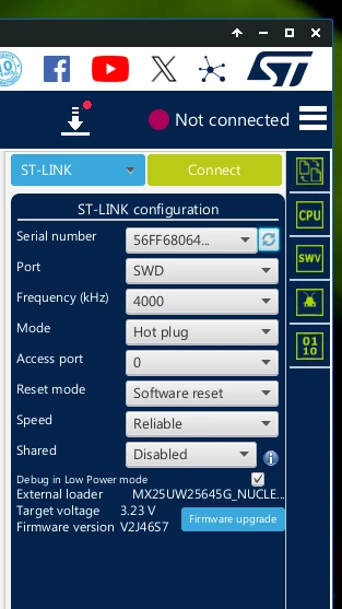

> How can I check whether the ST-LINK debugger is detected correctly?
Just (install and then ) use STM32CubeProgrammer, try connect st-link with these settings:
And for more help, tell:
  • IDE version, PC system
  • cpu , board name
  • st-link type (pic?)
  • what you read (first steps? video ? ) and tried
