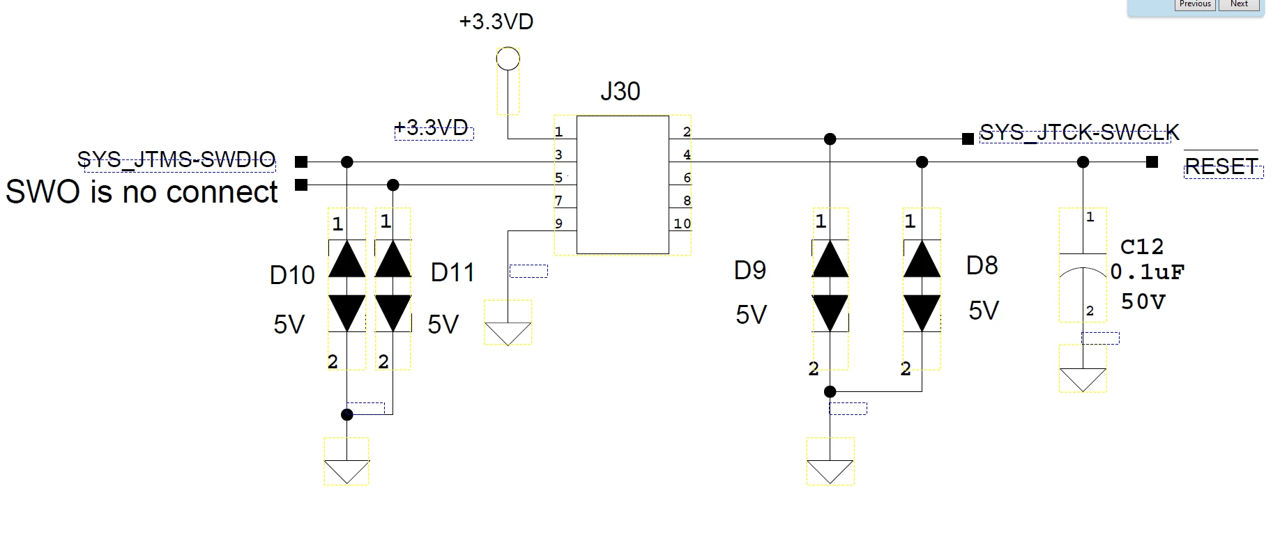

Hi All,
We are using MCU STM32F427ZIT7 for one for our products. We uses serial programming mode to program flash. Below is an interface with  10 pin
Now we are using below MCU for another application.
STM32F030C8T6TR
First one is F4 version and later is F0 version. As this is also from same STM32 series can we use same programming interface for this device as well?
Regards,
Amod

Yes, same interface will work fine.
The CM0(+) don't support the SWO/SWV/TDO/PB3 output, just use SWDIO, SWCLK, NRST
