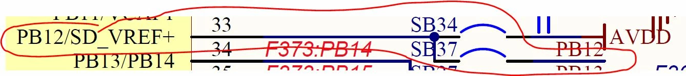

STM32- Nucleo-L476RG schematic: Why is PB12 (Pin 33) connected to V_ref/VDDA (Pin 13) ?
I'm designing a new schematic for am IOT project with STM32L476RGT and looked for reference
in the schematic of the Nucle-L476RG. In this schematic the  V_ref/VDDA (Pin 13) is connected to PB12 (Pin 33). Why are these two pins connected?
9 replies
Uwe Bonnes
Chief
Feb 13, 2020 9:38 AM UTC
I did not check, but I guess for L4, SB37 is bridged, while SB34 is removed. Only for F37 with ths SDADC, SB34 is bridged and SB37 is removed.

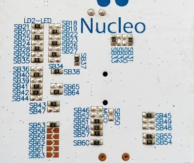

FHopp.1
FHopp.1Author
Feb 13, 2020 9:56 AM UTC
Thanks for your fast answer. But why is it bridged?
FHopp.1
FHopp.1Author
Feb 13, 2020 9:58 AM UTC
I made a picture of the bridges:
Uwe Bonnes
Chief
Feb 13, 2020 10:02 AM UTC
For the F37, you need SD_VREF on PB12. Otherwise you want PB12 to be accessible on the external connectors.

Amel NASRI
Feb 14, 2020 3:29 PM UTC
There is no SD_Vref+ for STM32L476. So when SB37 is bridged, this does not mean PB12 is connected to Vref+.
You need to look to SB57: it is ON which means "VDDA/VREF+ on STM32 is connected to VDD" (referring to UM1724).
-Amel
