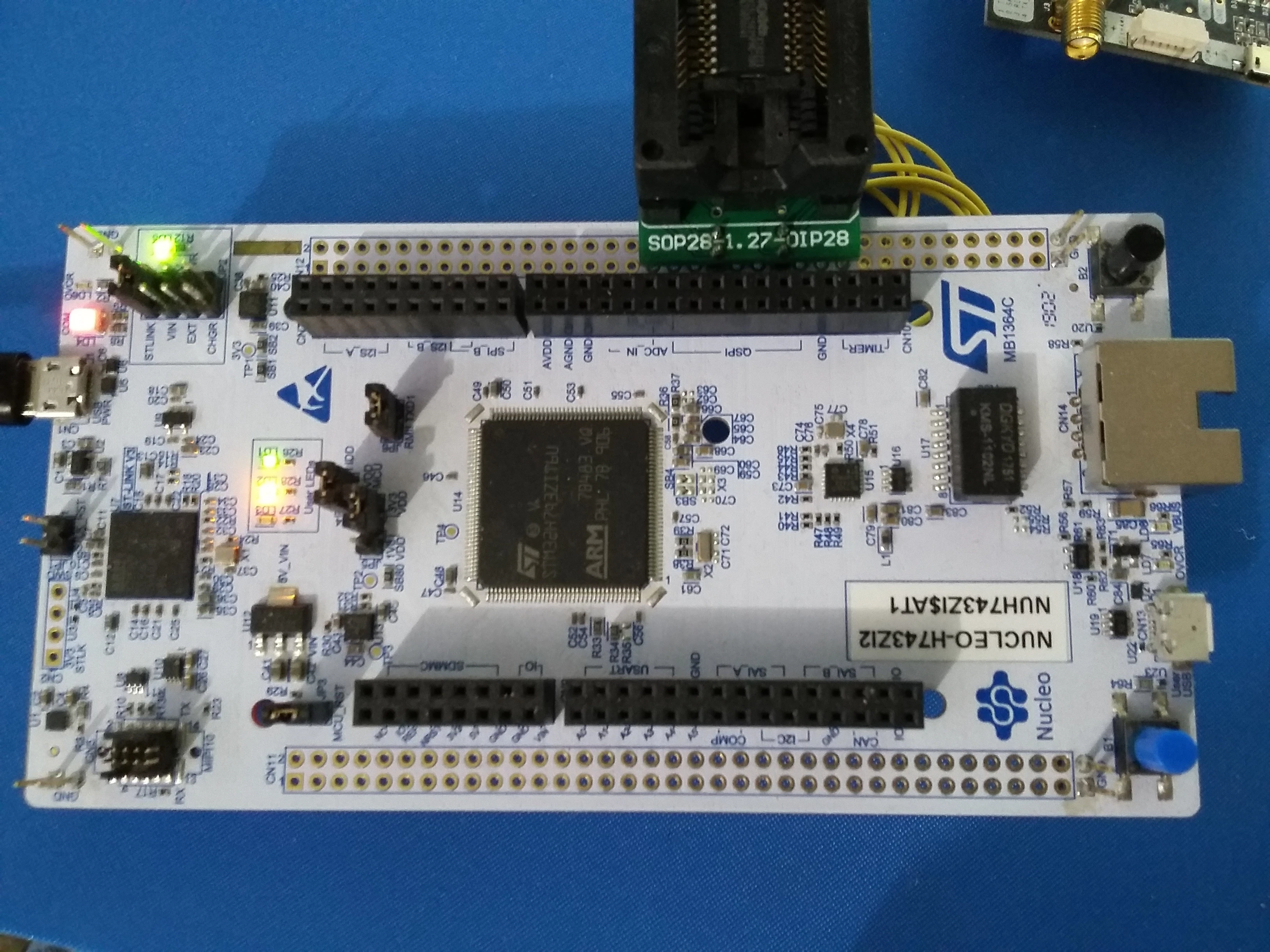

December 21, 2019
hello,
I have tested your image on three different H743ZI2 boards, but I never receive any message on the VCP.
the LEDs are blinking however.
all other STM boards I have give me output over the VCP.
this is crazy... I am thinking if all three boards are broken...... but this is highly unlikely
do you have a picture of your board of FRONT and BACK ?
I want to compare the solder bridges and so on if there is any physical difference.
kind regards
Tesla DeLorean
Guru
December 21, 2019
Will see what I can do.
SB5 and SB6 should be ON, SB4 and SB7 OFF
Jumpered for 3.3V operation JP5
Rev C board
Will see if I can get the angle, focus, lighting better
