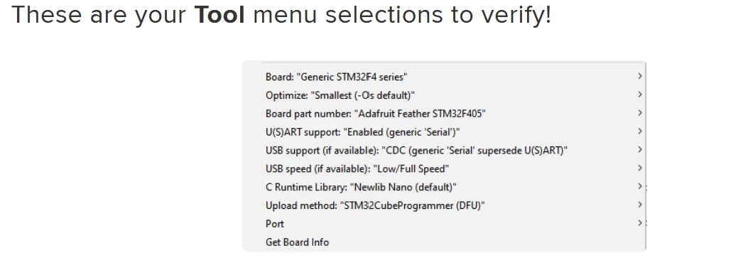

I'm trying to use Arduino 2.3.2 with an STM32F405 board and I configured it to use these recommended settings, but I can't open the Serial monitor for the board. It can connect to my laptop and even upload code successfully, but I can't access the ports menu and receive Serial output from the board.

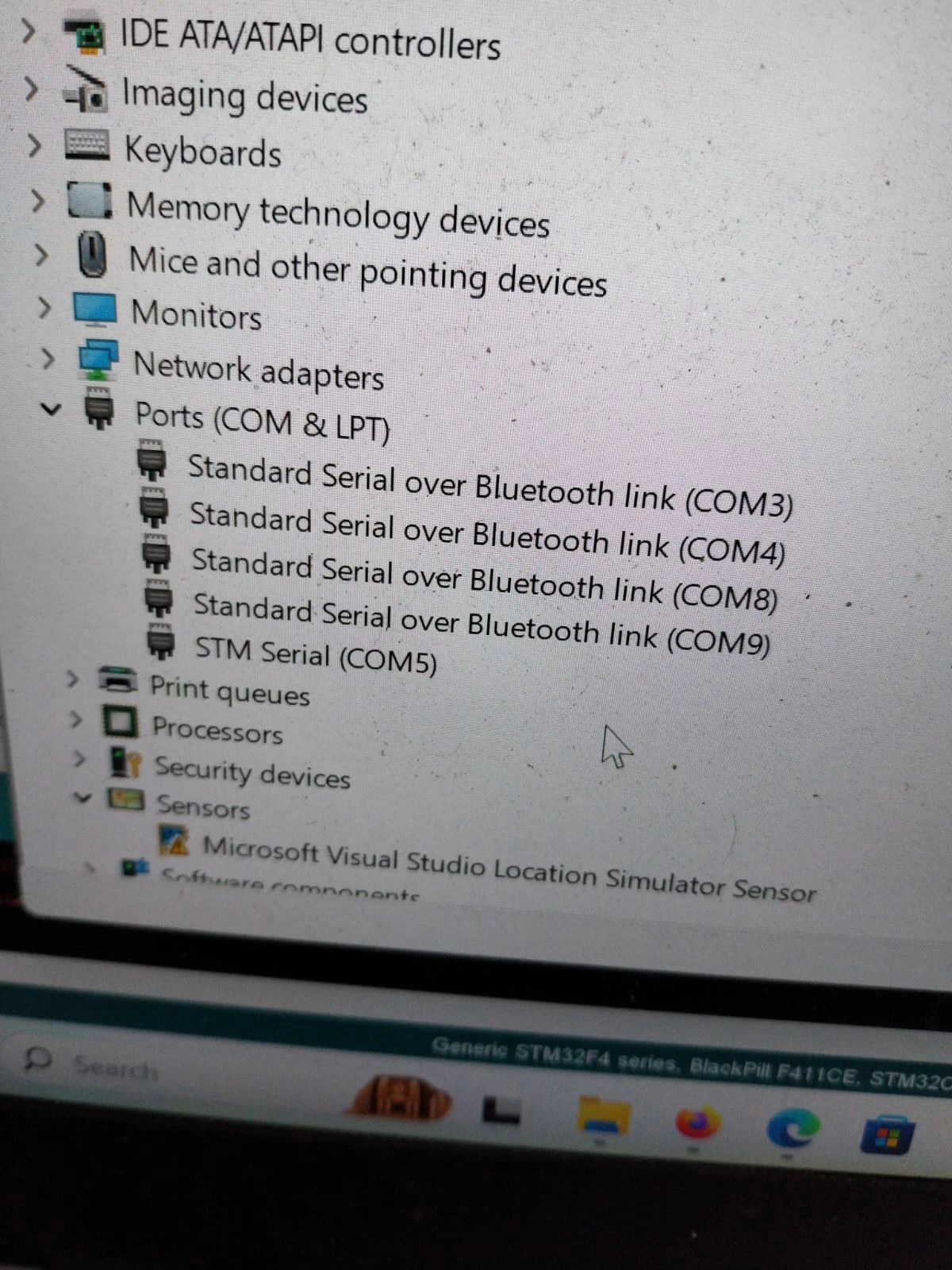

I'm able to get the Ports menu to open back up if I go into the Device Manager and add additional ports, but usually my boards use COM3 or COM5, which I cannot access through the ports menu. All of the legacy hardware I install (tried the Arduino USB Serial adapter and the STMicroelectronics Virtual COM port) will only install in ports after 5. I was only able to get it working once, and that was when I was able to connect to COM5, but I don't know what happened to allow access to COM5, and it stopped working as soon as I attempted to upload a different sketch to the board.

@vs13 wrote:
 I configured it to use these recommended settings, .
That page says you have to manually put the board into bootloader mode every time you want to upload - are you doing that?
Yes, I am putting the board into bootloader mode every time I upload. The upload seems to be happening successfully, but I can't connect to and read the Serial output after I disconnect the wire and press the Reset button.

@Techn wrote:
After the code is uploaded, press reset,  check device manager, serial ports. In arduino change the serial port as per device manager and then open serial monitor
When the board is connected in bootloader mode, all of the serial ports show as disconnected (greyed out and hidden) in the Device Manager. When I disconnect bootloader mode, the board disappears from my device list and the Serial ports are still hidden and grayed out.
