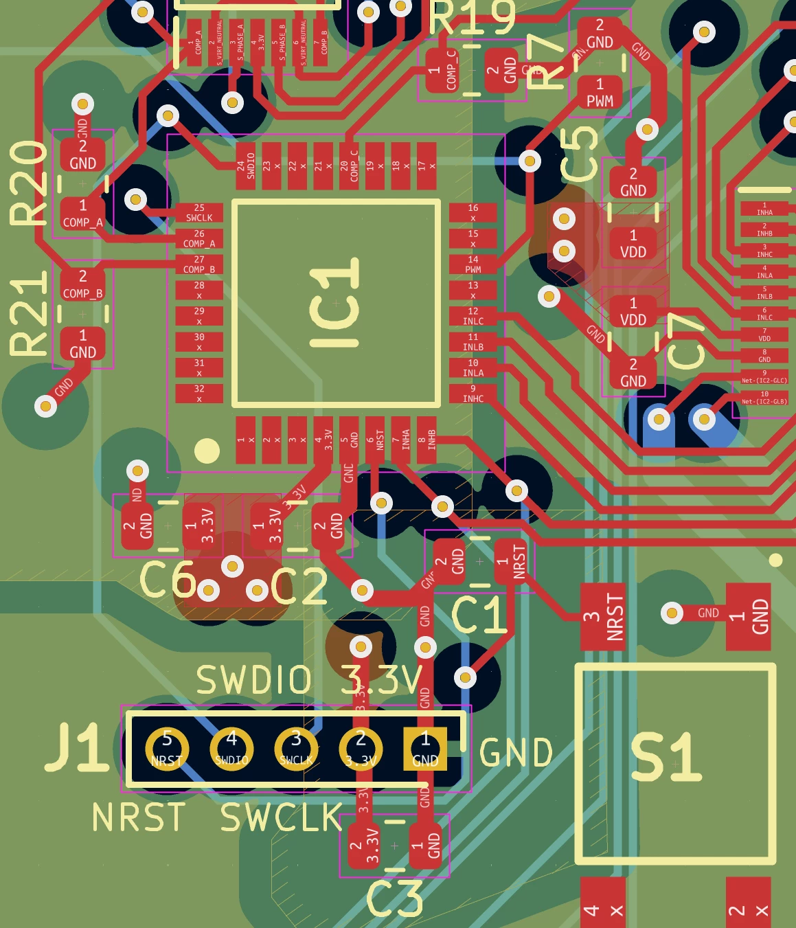

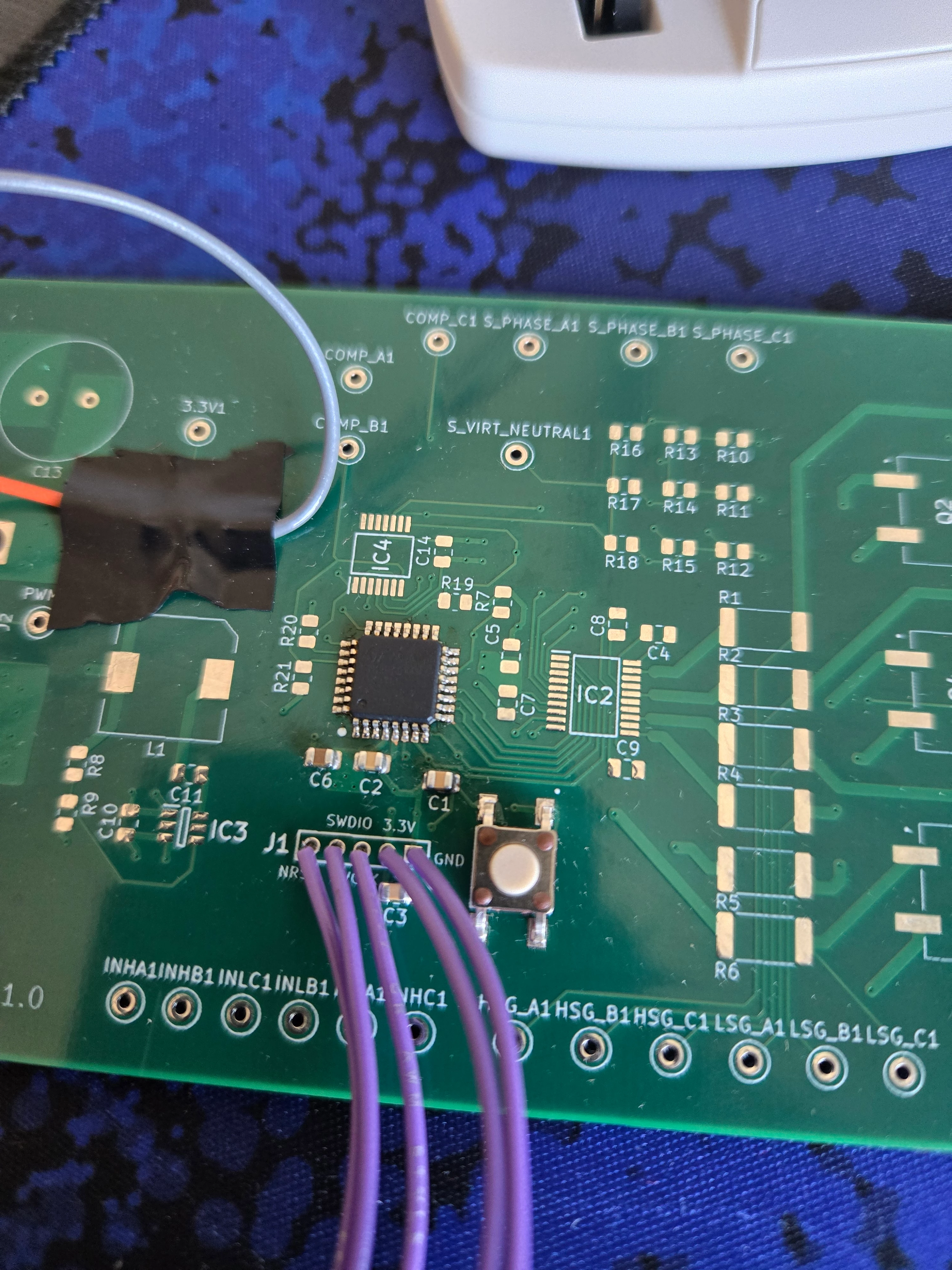

I created a custom STM32 board for a motor controller, but I am having trouble even programming it using the STLink V2. I am using the STM32C071KBT6N MCU that I purchased from Mouser. I soldered it onto my board using drag soldering. I soldered other components near it with hot air.

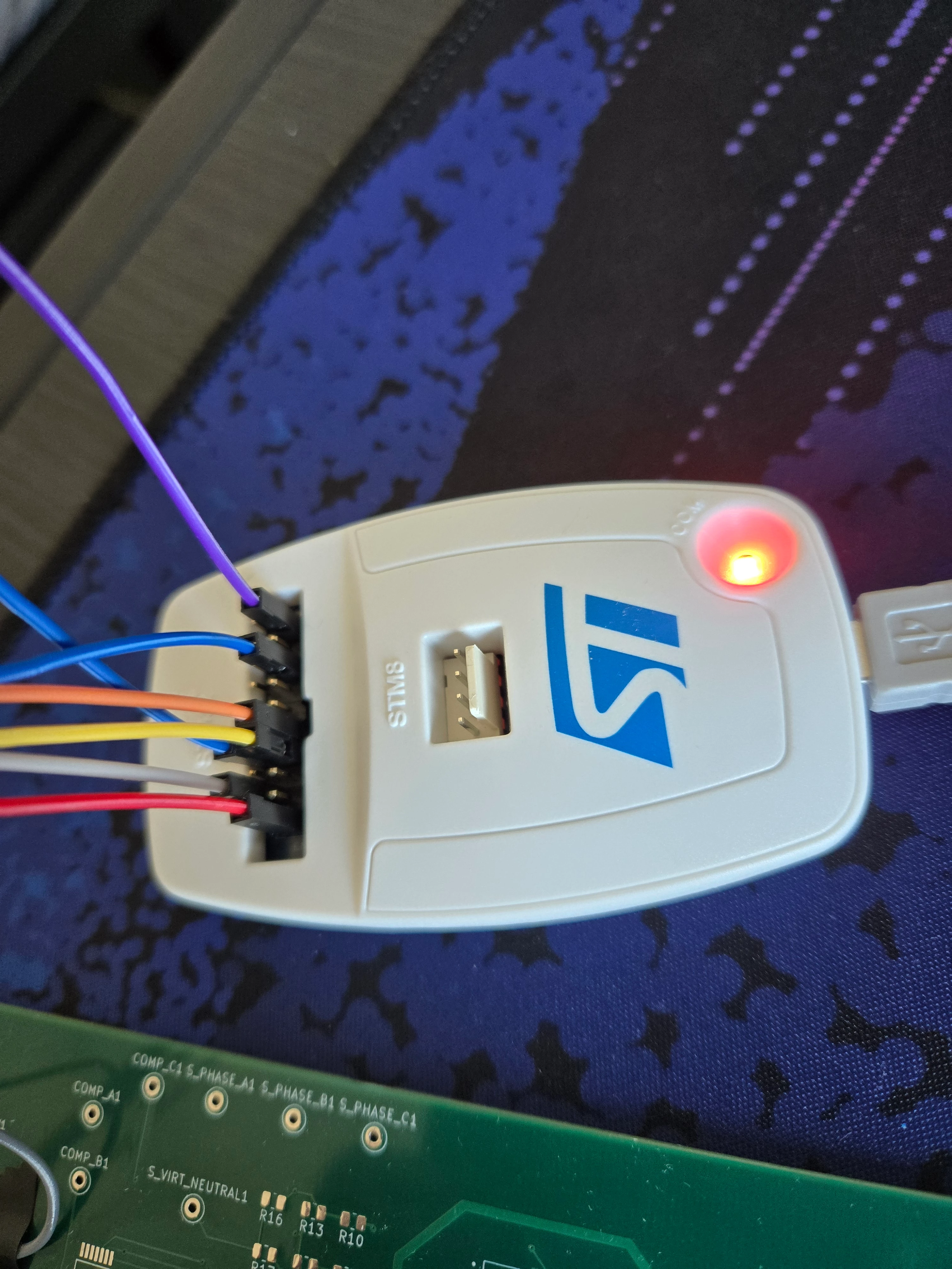

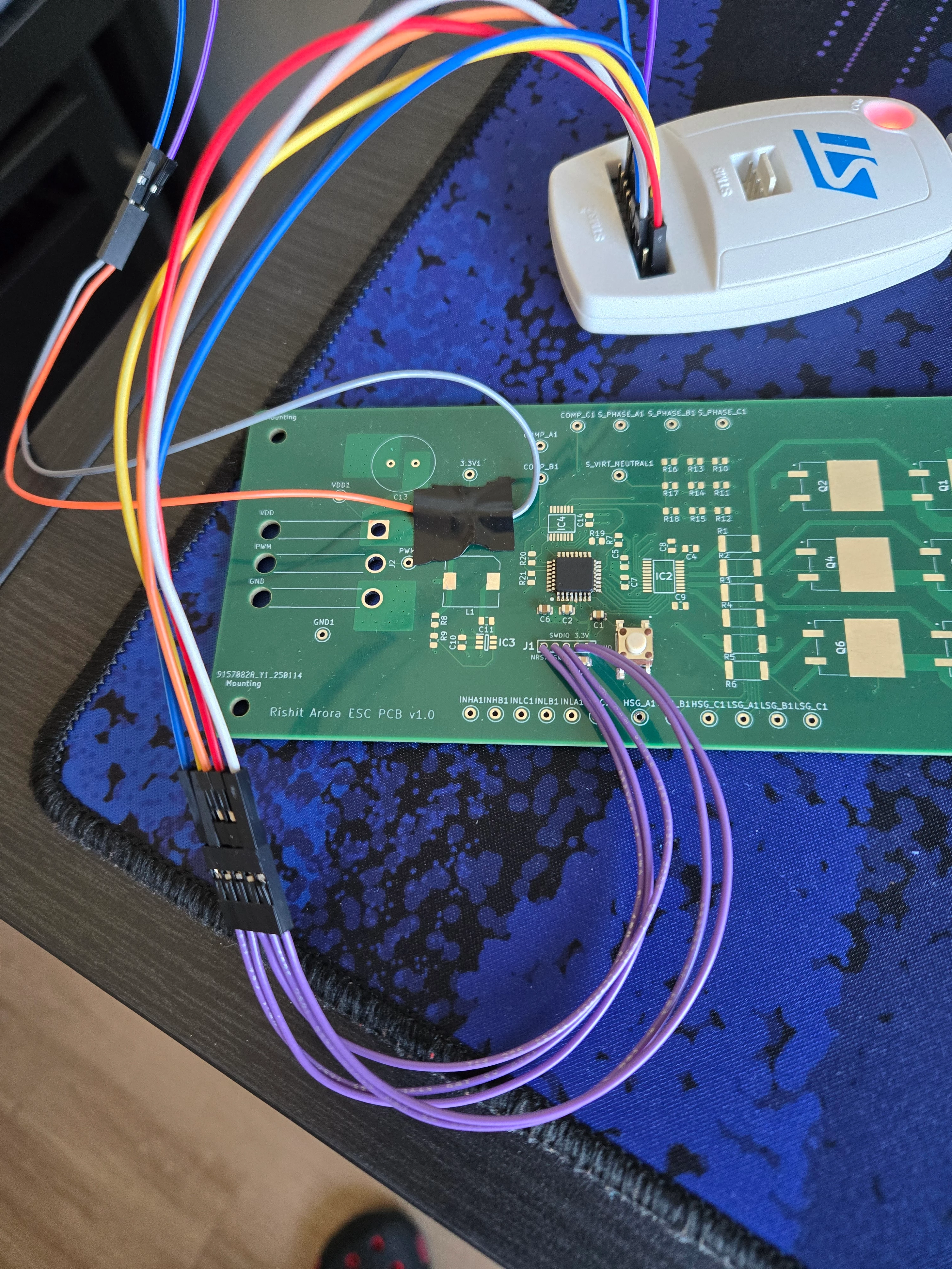

I have tried to power the board through an external 3.3V power supply and through the STLink itself.
Rishthegreat_0-1741462936533.pngRishthegreat_1-1741462985606.pngRishthegreat_2-1741463081337.png20250308_134522.jpg

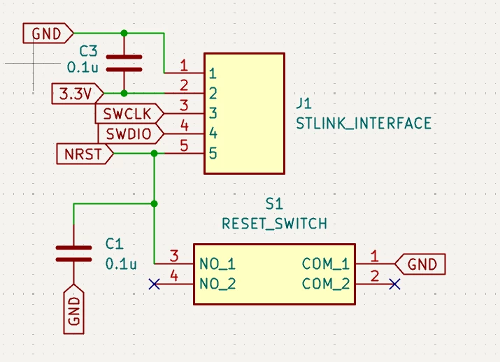

This STM32 model has the same pin for PA14-BOOT0 and SWCLK. But I just directly connected the pin to the header for STLink V2.

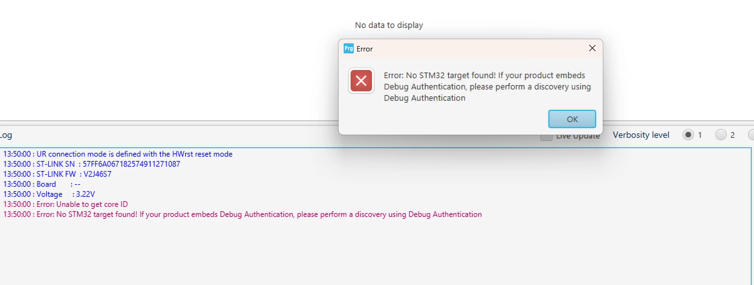

I get this error in STM32 Cube Programmer.

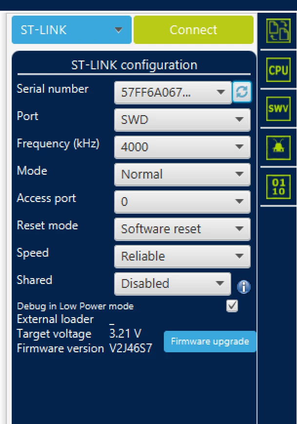

And these are the settings I am currently using.
I have tried different combinations of settings and have held the reset button down, but I still end up with the same error.
I am not sure if something is wrong with my design, the chip that I received was bad, or I somehow destroyed the chip while soldering.

Design looks correct. Chip is unlikely to be damaged by soldering--it is quite robust.
Most likely thing is a bad solder joint or a mistake in wire connections.
It's so much easier to put a standard programming header on the board and use that. Saves time and takes the guesswork out of stuff like this.
Measure voltage on the board. On the actual STM32 pins if possible-to ensure it is powered. Not sure how power is being supplied here. BOOT0 pin state doesn't matter as far as establishing a SWD connection. As I recall, the chip boots up into the bootloader when empty regardless, although it doesn't matter here with no program loaded.
Ensure pin 5 has a good connection. I see parts of the gold pad of the board--solder definitely didn't wet the entire pad.

For the pin 5 you were mentioning, I think a bit of the green solder mask came off.
I will first try making the SWD wires shorter to see if that helps (I saw somewhere that it helped). Then I will try desoldering the chip, cleaning the board with alcohol and then resoldering it back onto the board to see if that helps.

If the problem is still not solved, here is another (completely different) approach.

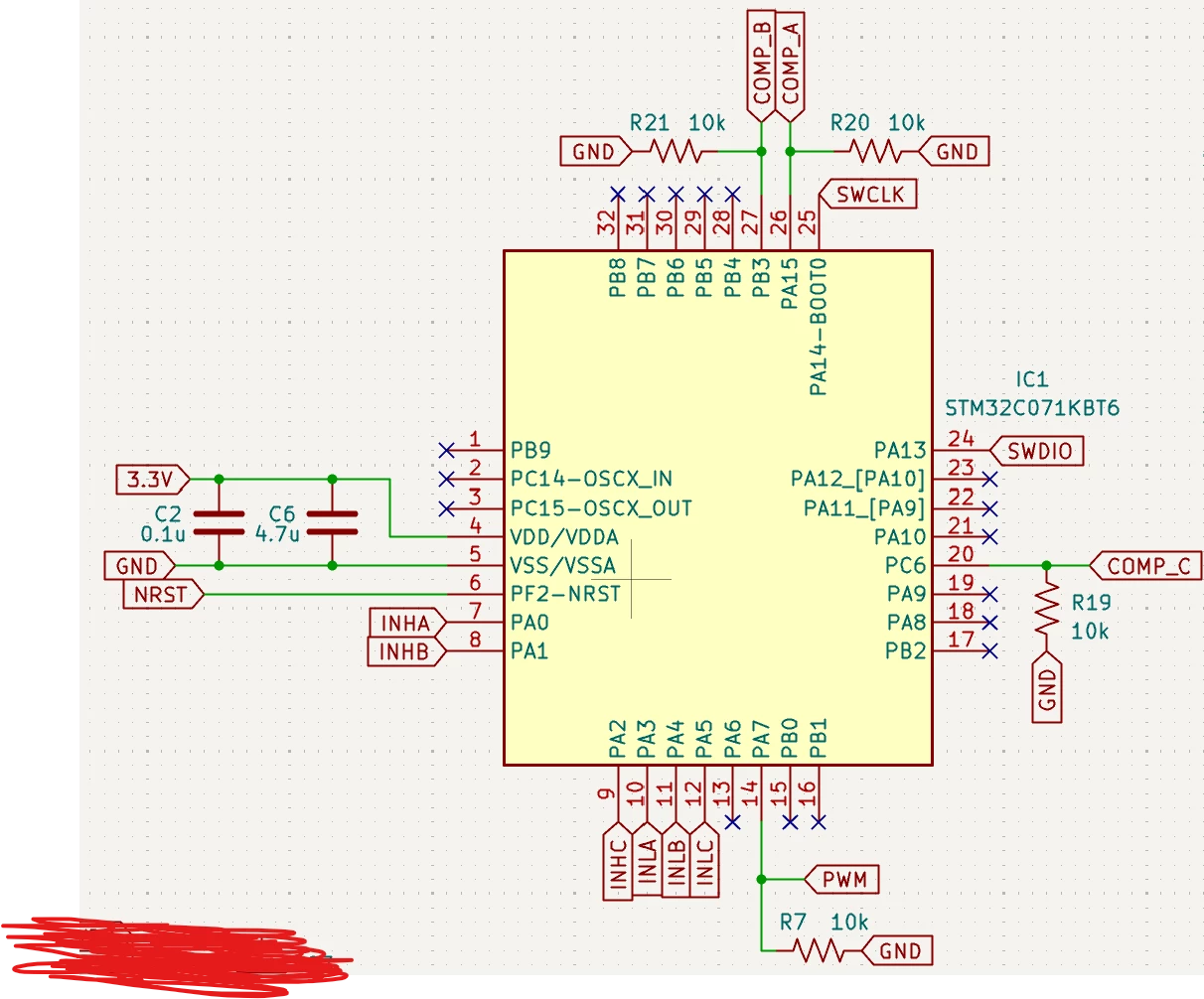

If you look at the second circuit diagram at the beginning of this thread, the MCU (IC1) is listed as an STM32C071KBT6, but an STM32C071KBT6N (N Version) is used.
The STM32C071KBT6N has VDDIO2 connected to pin 20 and not PC6 as with the STM32C071KBT6.
The VDDIO2 connection is used to supply ports PA08 to PA15. These I/Os are therefore not connected internally to VDD and are therefore not powered and not functional.
Of course, PA13 (SWDIO) and PA14 (SWCLK) are absolutely necessary for the SWD connection.
Connecting VDDIO2 to VDD should solve the problem and get the SWD connection working.
For more details, see the STM32C071x8/xB data sheet (DS14693 Rev 1) under “Figure 6. STM32C071KxT LQFP32 pinout” on page 32/129.
