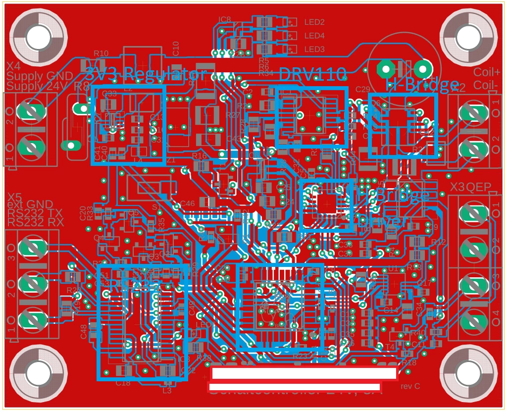

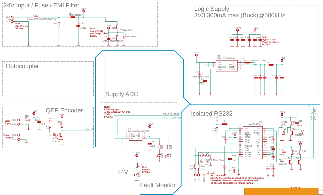

im currently working on a custom pcb which uses the STM32L031K6 and im having some troubles with it.
Ive attatched the schematic and some oscilloscope measurements.

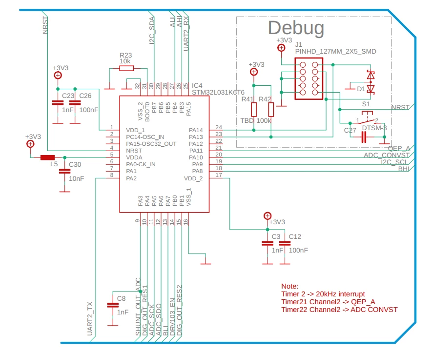

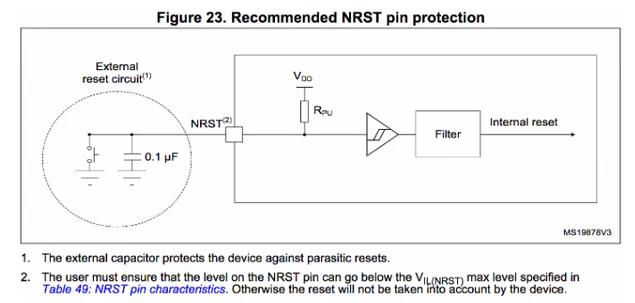

You don't seem to have the RESET pin pulled high.
A floating reset pin may give you periodic problems.
Andy
May 25, 2020
The STM32L0 has an internal pullup on NRST.

0693W000001pQqnQAE.pngReset connection looks to be in order when checking the HW guideline.

It looks like your boards have isolation, perhaps motor controllers, and some high current / high-voltage stuff going on. I'd have a look to make sure something in this environment isn't killing your micro :

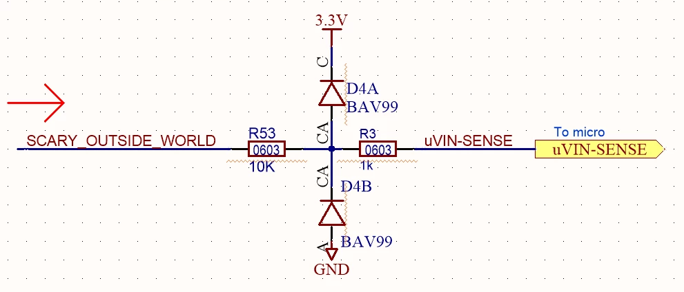

1) That micro has no clamps for positive over-voltage on the I/O. Thus it can be broken easily by any kind of inductive spikes or ground bounce. When a pin dies, try measuring resistance to ground and to +3V3. That may give you some clues. Also check the resistance values while the micro is powered up and while off. If you see a resistance path to GND in the order of kΩ, suspect a HV spike with low energy behind it. If you see ohms, something with current behind it has trashed the pin. See if you can still measure the negative clamping diode for the pin to check if it's still there. If you have inputs coming from off-board or high-current/voltage sources, isolate with a few hundred to a few kiloohms in series (Adjust R53 according to your needs), AND add a clamp to supply, and then another resistor in series as well (R3 can be as low as 100 ohms, but do your calculations assuming an ESD hit of 8kV from a 2k source) - if there is e.g. a negative going spike, you don't want the current shared between your protection diode and the internal protection diode. I use the scheme below for all inputs that travel any distance or to a pushbutton or LED anything that might pick up static from a user/machine. A BAV99 can take 2 or 4A for a microsecond and is almost free and has practically no leakage. If you can't clamp to your 3V3 rail due to too little current draw (micropower designs e.g.) then clamp to a shared transzorb, even if you have to pre-bias it to supply.
2) Check your grounds. Make sure there is no ground shift happening due to high currents in the groundplane/fill. Make sure both VSS pins are connected to each other very solidly, and to same GND as your input signals. If you have high current, make sure your micro is on its own, quiet, ground with no current flowing in it. And a nice ground fill underneath it if you can. If you're on a 2-layer PCB, you may struggle. Check for placement of switching regulators and other sources close to the micro, especially keep the SW pin away from the micro.

6) Check that reset line - I think there's supposed to be a 1k resistor in series with the cap on the reset line. And a push-button can be a nice place for static to enter a micro, so consider whether it needs a clamp.

  3. Ill include some additional protection via BAV99 at controller pins and a 3V6 Zener at the output of the 3V3 switching regulator in my next revision, thank you for that idea.
  4. I tried to keep all funcional groups (µC, 3V3 switching regulator, RS232, H-Bridge) as far away from each other as possible, so theres minimal interference with each other, local ground shifts or anything alike. I uploaded the PCB as well. However, im aware that the ground connection underneath the µC seems to be lacking, so that might cause the issue.

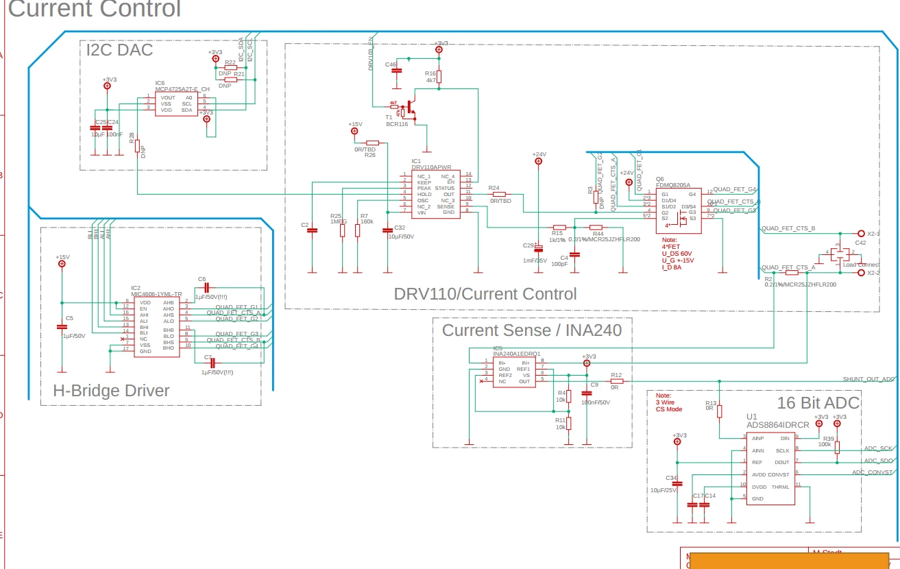

It looks to me that this schematic is haunted by evil spirits from the past.
The so called bridge driver is :
FDMQ8205A is GreenBridgeTM2 series of quad MOSFETs for a bridge application so that the input will be insensitive to the polarity of a power source

I know the FDMQ8205A in this case maybe is a bit off-use, but it looked like an ordinary h-bridge to me. (however oddly small package for 8 amps) I got it running to about 3amps and the case got barely over 40°C
On each board revision i tried out a different power stages.
-DRV103, internal low side MOSFET - worked fine
-DRV110 with an external low side MOSFET and shunt voltage sense/current control - worked fine
-H-Bridge with FDMQ8205A & DRV110 (current revision) - also works

Ive uploaded the PCB and a measurement of the Vdd supply.0693W000001pQWiQAM.bmp

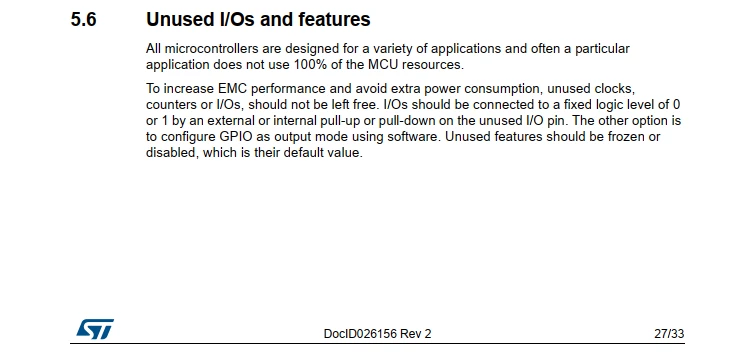

Another thing that comes to mind is how to proceed with unused µC-pins, as that might also cause issues. The HW guideline doesnt seem to be clear to me on this issue.
Connect unused pins to GND and set them up as inputs with pullups/pulldowns enabled?
