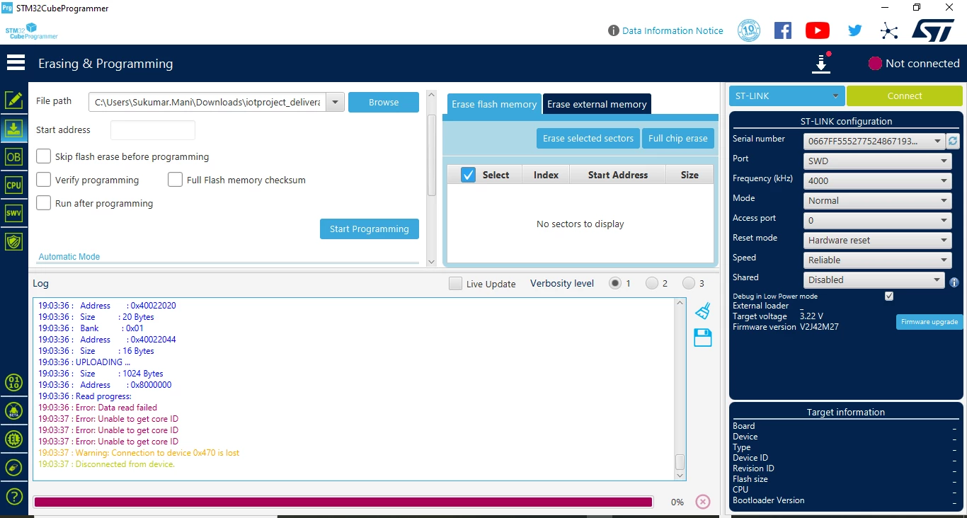

Dear Team,
 I have facing Below issue Could you please anyone Help me to resolve this issue.

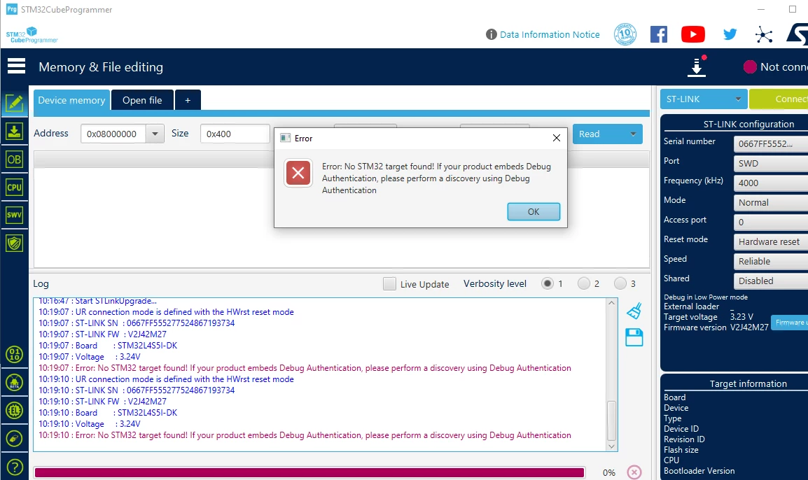

Hello @M_Sukumar
You may try to read option bytes with STM32CubeProgrammer specially the RDP option bytes.

M_SukumarAuthor
July 11, 2024
    I have tried That method as well If I am using USB means Connected But if I'm using Stm Link Show error and Controller as produce too much heat.
