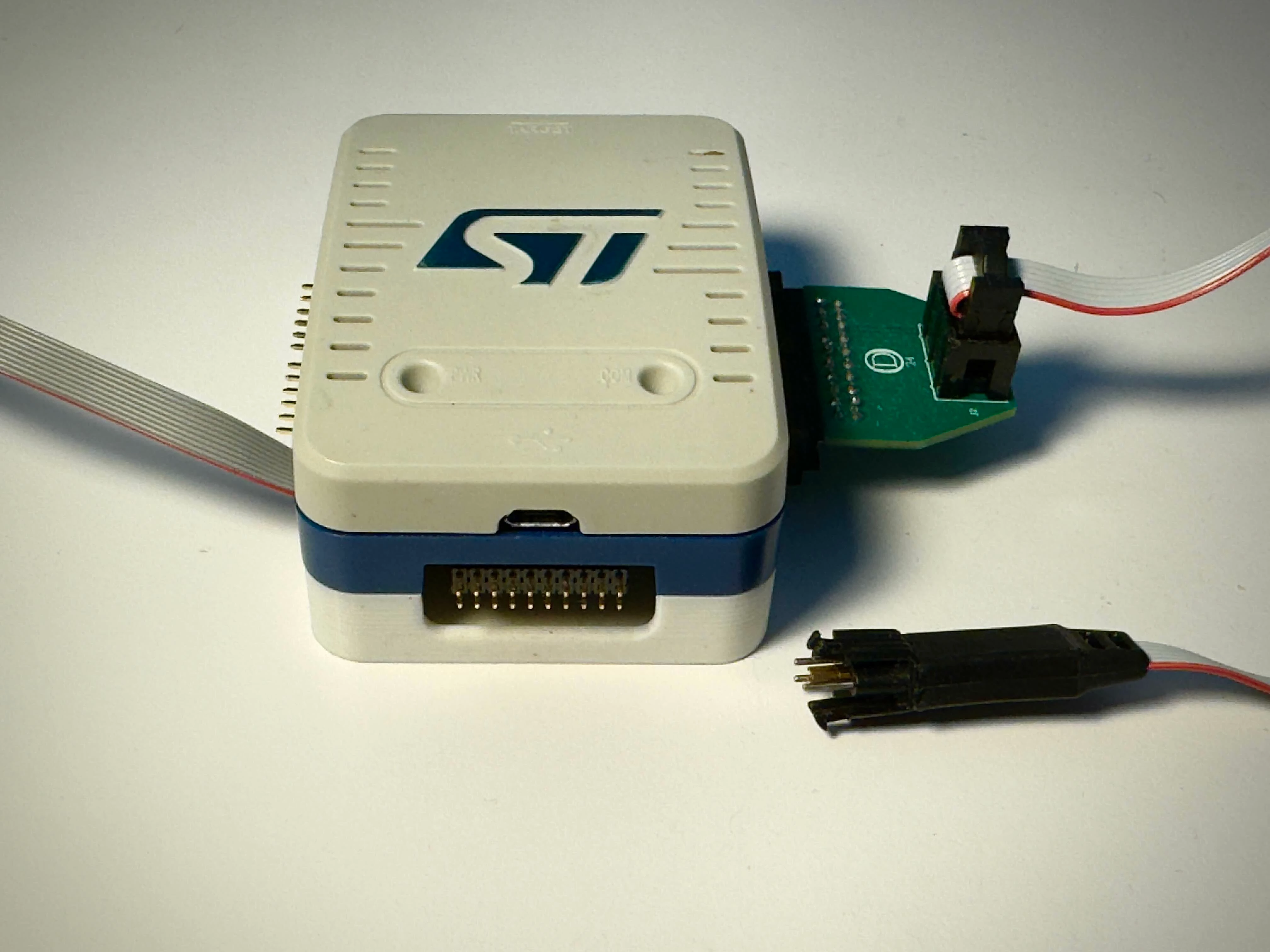

When the STLINKV3 is used with the additional connector board (MB1440) the lower back can no longer be attached. This means that the LEDs on the top are no longer visible. I have designed a 3d-printable lower cover that remedies this :
I have also made a little board that allows me to connect a 6-pin debug probe to the JTAG connector.
The files can be found on my github page:
github.com/olafdreyer/stlinkv3mod
