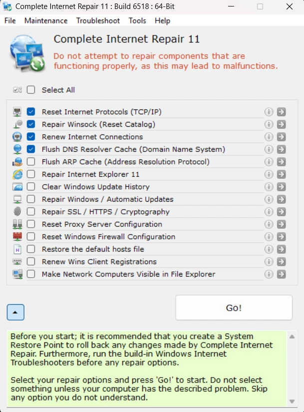

It's FIXED !!!!!!!!
It was indeed a winsock problem and I fixed it by installing a simple app called "complete internet repair" from Rizonesoft.
I selected these options and when it's done I rebootedmy pc and IT WORKED !
Thank you for trying to fix it with me, the winsock hint was very helpful.

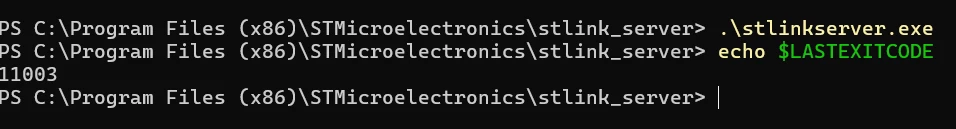

Pavel A.
Apr 27, 2026 11:12 AM UTC
>  When I try to manually execute stlinkserver.exe via PowerShell to see what's wrong, it exits instantly without printing any output, errors, or logs.
What is the exit status in these cases? use powershell command echo $LASTEXITCODE  or cmd command echo %ERORLEVEL%
Also, check whether another instance of stlinkserver.exe is not running in background, stuck for whatever reason.

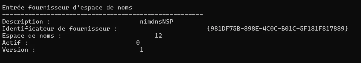

Apr 27, 2026 7:19 PM UTC
I think it is a Winsock API error,
I have this in winsock show catalog which is from another app I did uninstall it before. (LabView from National Instruments)
I tried deleting it from regedit and the moment I reboot, windows crashes and wont boot, I had to recover from a restore point.
Also, I found a dll file with the name nimdnsNSP.dll which I did delete it (only been able to inside safe mode)

adelmgadmiAuthorBest answer
Apr 27, 2026 7:33 PM UTC
It's FIXED !!!!!!!!
