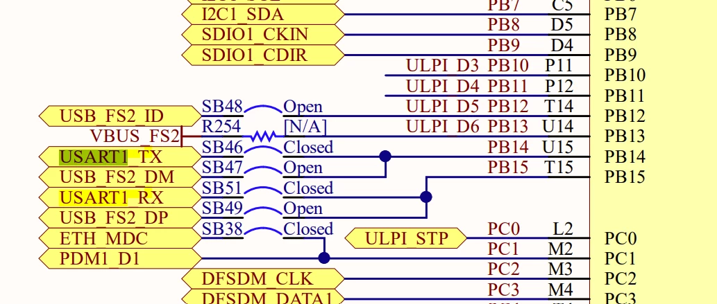

I am working with the stm32h757 EVAL board, and I am trying to send some data to the PC using USART via STLINK VCP however I am not receiving anything on the PC side.

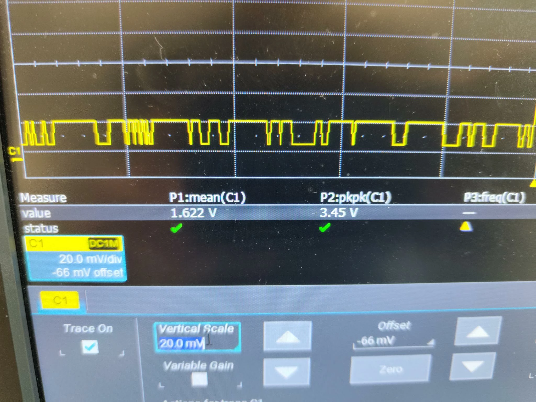

In the board user manual and schematics, it says that USART1 is connected to the ST-LINK V3 controller using pins PB14 and PB15 I have configured the USART1 and used pin PB14 which is the TX PIN and I have checked the pin on the oscilloscope and I can see the data being sent also I have checked the data on the jumper that connects to the STlink and it is sent. Yet I am not receiving anything on the PC.

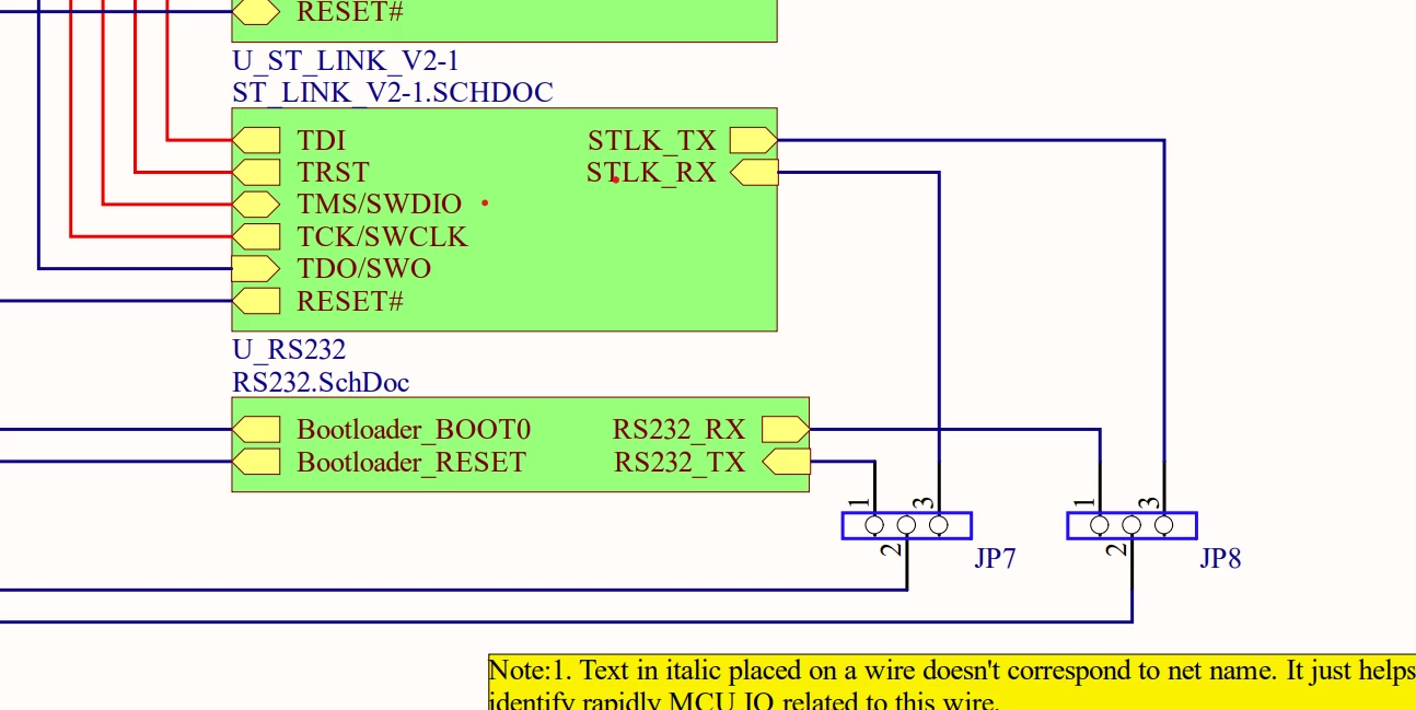

It is confirmed that PB14 and PB15 are used for RS232 on STM32h757I-EVAL.
Pls note that pin2-3 is closed for both JP7 and JP8. otherwise these two pins are not connected to STLINK.
