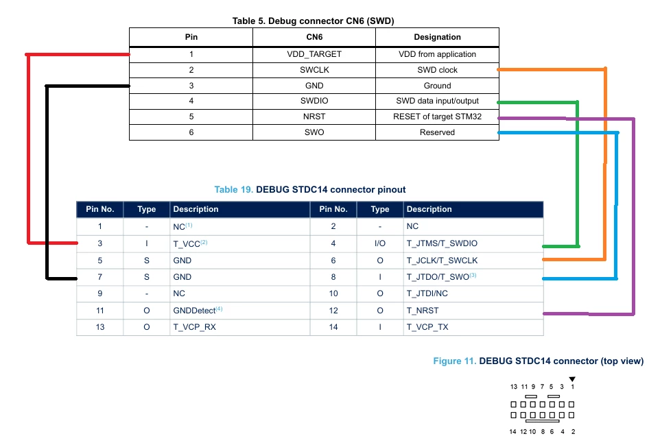

I am trying to link up a Nucleo-F411RE board to a STLINK-V3PWR unit via the SWD (CN6) header.
I am going to make a breakout board for the connector. See image below, I am assuming that I do not have to connect T_VCP_RX and T_VCP_TX to anything on the Nucleo board, am I right?

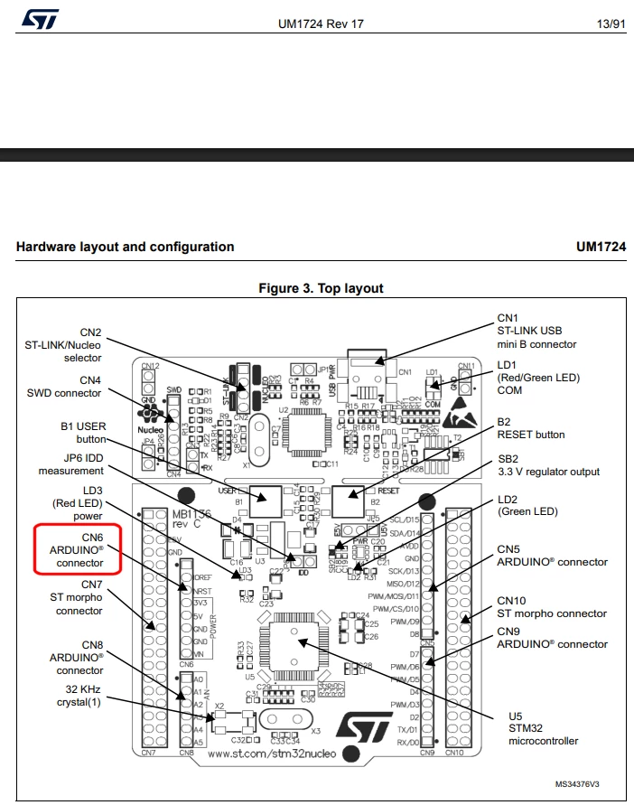

On a Nucleo-F411RE board (MB1136), CN6 is the Arduino power header - not SWD:
https://www.st.com/resource/en/user_manual/um1724-stm32-nucleo64-boards-mb1136-stmicroelectronics.pdf#page=14
via: https://www.st.com/en/evaluation-tools/nucleo-f411re.html#documentation
Did you mean CN2, or CN4 ?
Don't forget that you will need to disconnect the built-in ST-Link before using an external one.
The CN2 jumpers disconnect the SWD lines, but not NRST.
So long as you don't want to use the VCP functions

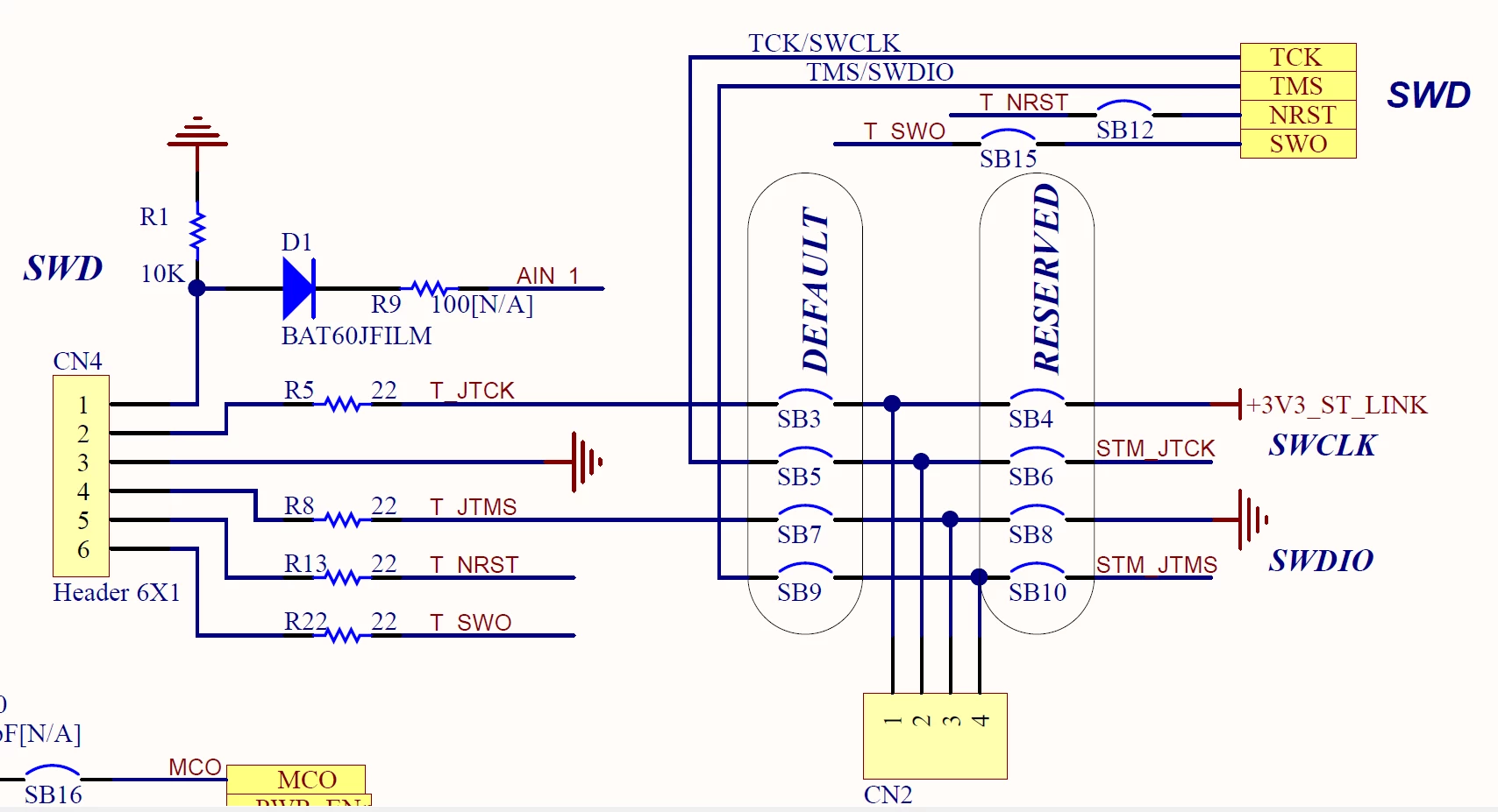

Apr 28, 2026 10:13 AM UTC
Ahhh yes I had the wrong datasheet open! Yes I mean CN4.
So after removing the jumpers on CN2 I will be able to program the board via CN4 or just get debug?
Andrew Neil
Apr 28, 2026 10:33 AM UTC
No.
CN4 is to allow the Nucleo's ST-Link to program an external target: it is debug out - not debug in.
See the Nucleo-F411RE User Manual (link above) and schematics:

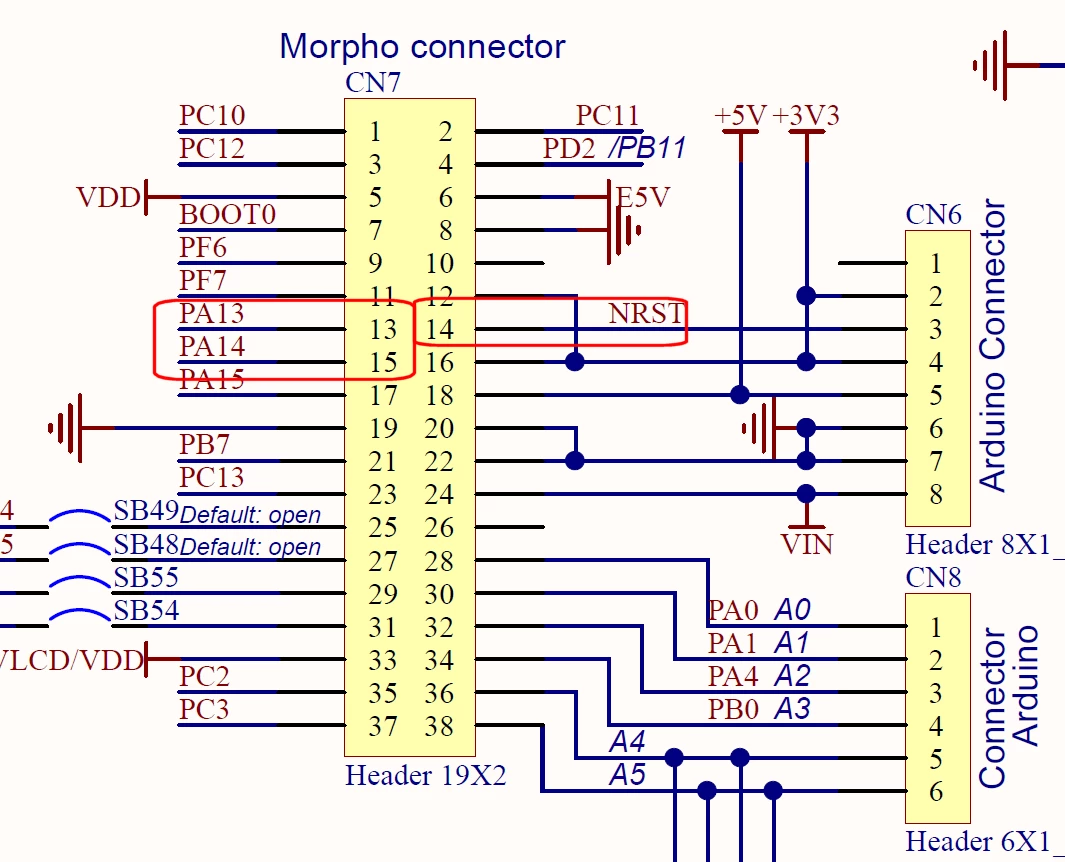

As you mention STLINK-V3PWR, I guess your aim is to do current measurements?
In that case, you would be better breaking-off the ST-Link part of the nucleo, and connecting the STLINK-V3PWR via the SWD (and NRST) pins in the CN7 Morpho connector.
That way you'll avoid any misleading current measurements due to the Nucleo ST-Link...
