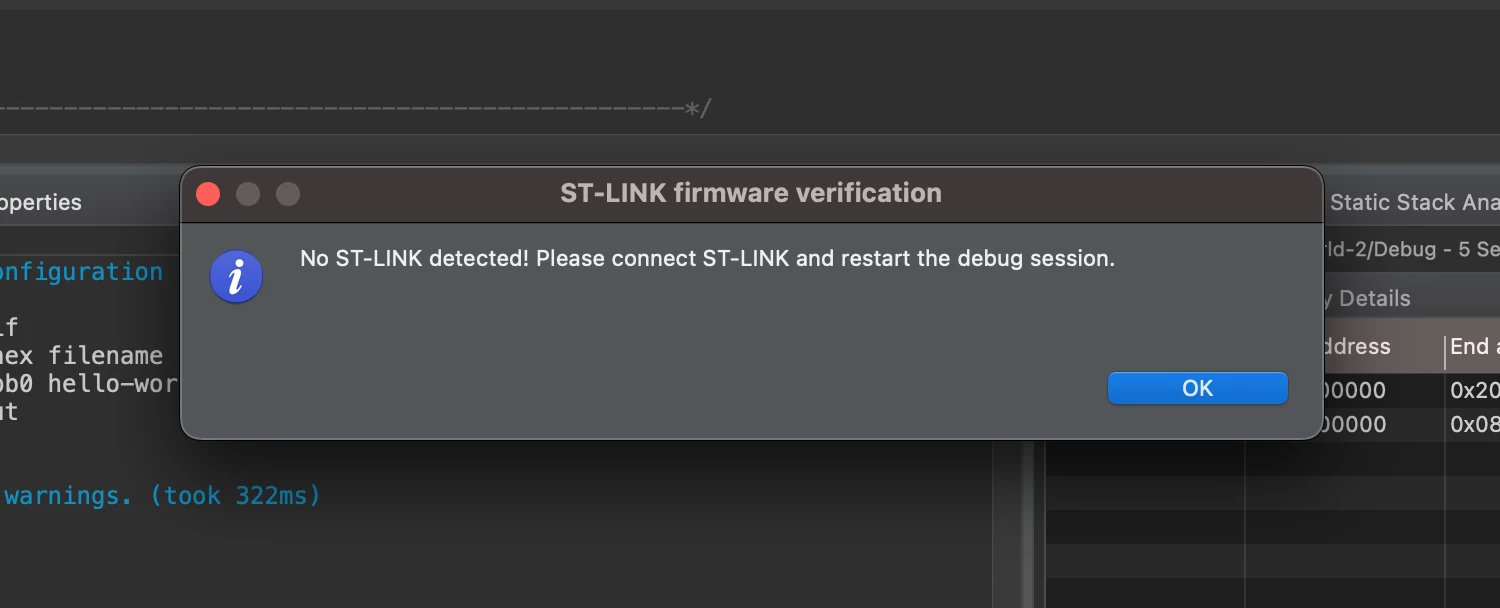

When I try to connect a target using SWD with my STLINK-V3PWR probe I get the following:
"No ST-Link detected" in a popup named : "ST-LINK firmware verification"

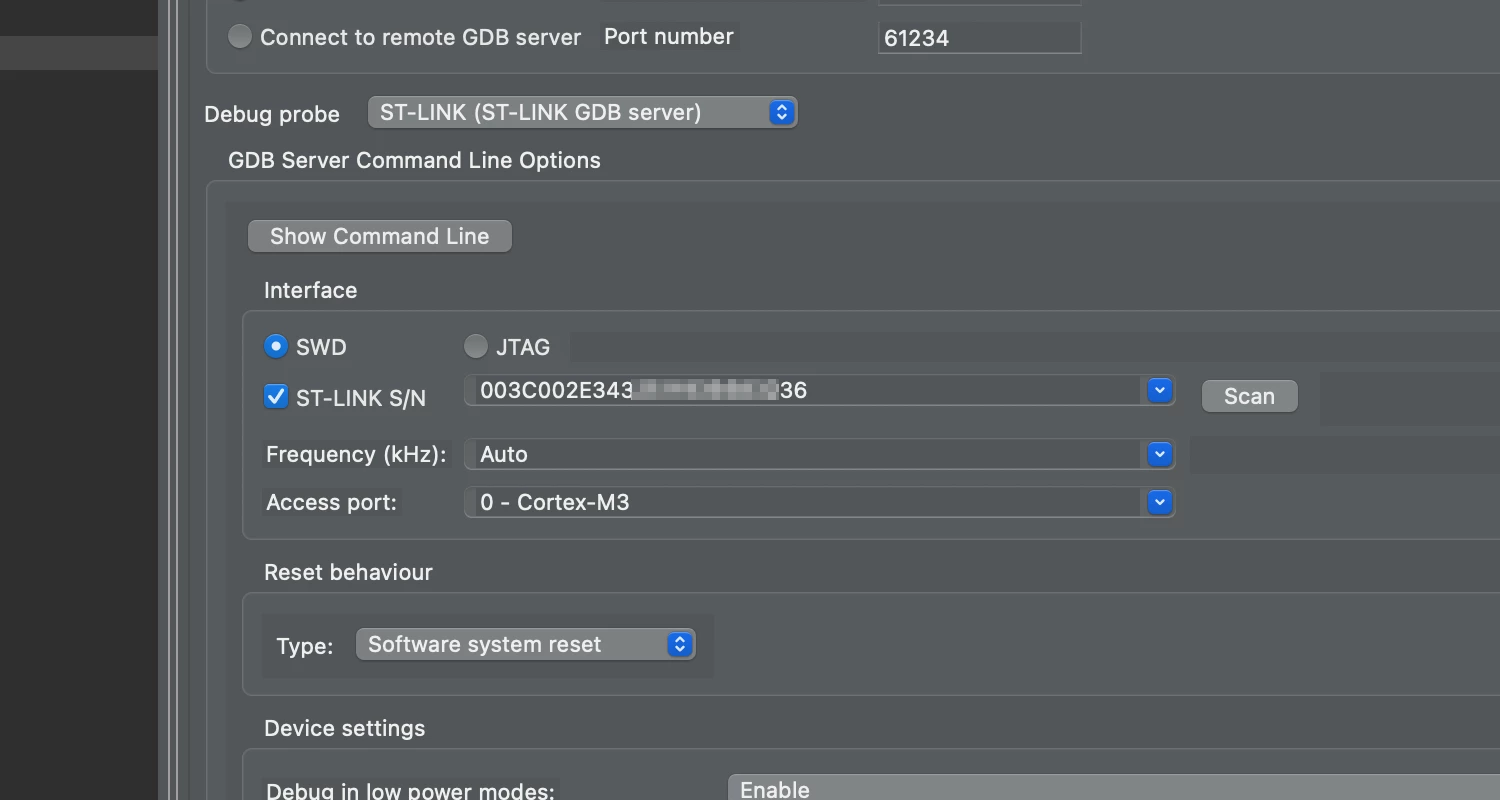

The "scan" button report the prode ID : 002F00383431510137383732 that seems OK

All that ends in ... 'No ST Link detected' popup message :(

You also have to know that the problem arises before I connect the device to debug. I mean that just plugging the V3PWR probe on the USB with nothing connected on the SWD lines, I have the same error popup saying the probe is not recognised !!!

Another idea is to verify the probe serial number. Could you please open the system preferences, then select, under material, USB. Then expand the Bus USB xxx under which the STLINK-V3PWR is listed. Click on it, and verify that the serial number is the same as the one detected by CubeIDE.
This to be sure that CubeIDE do not keep the v2.1 probe serial number.

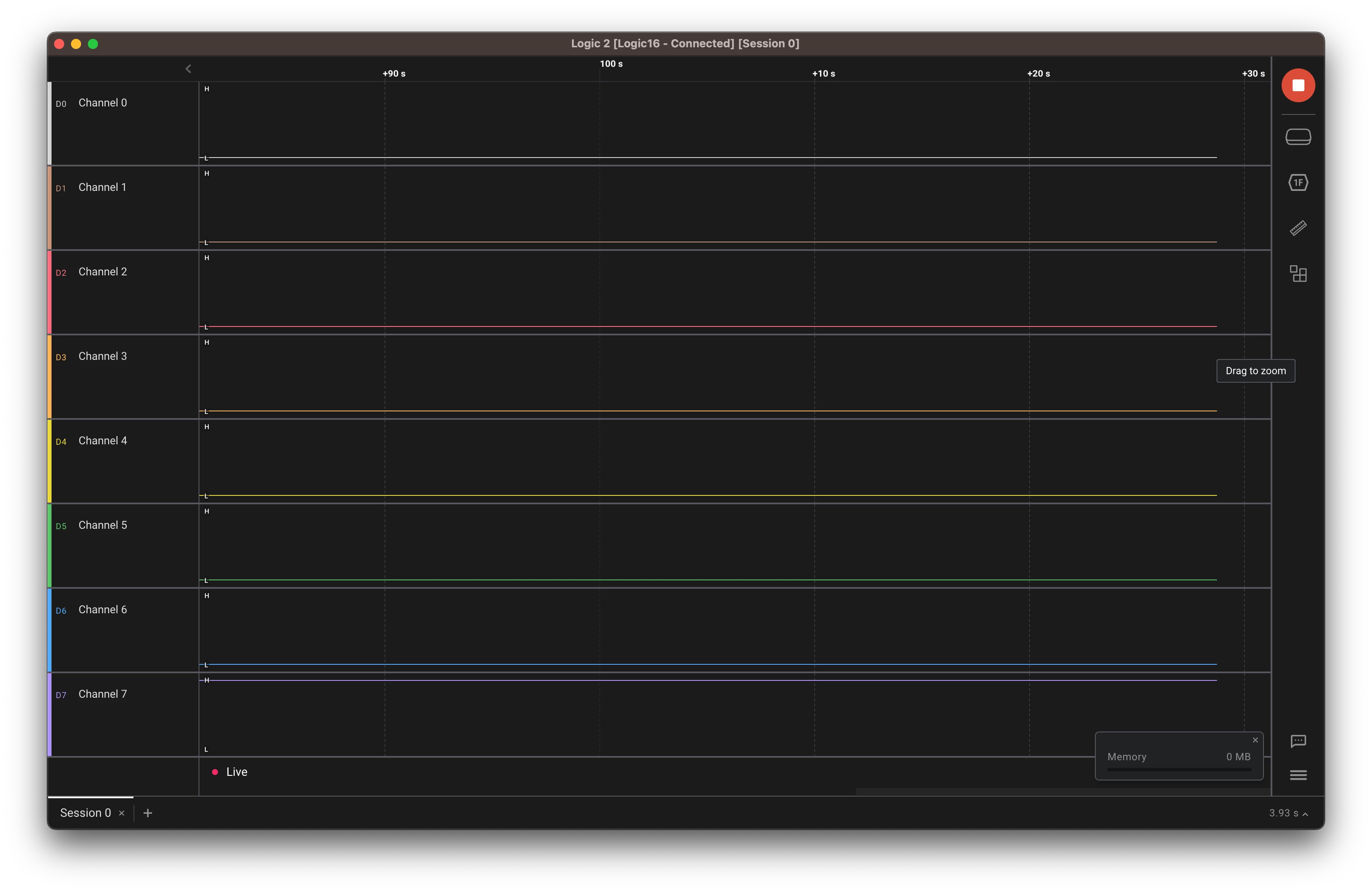

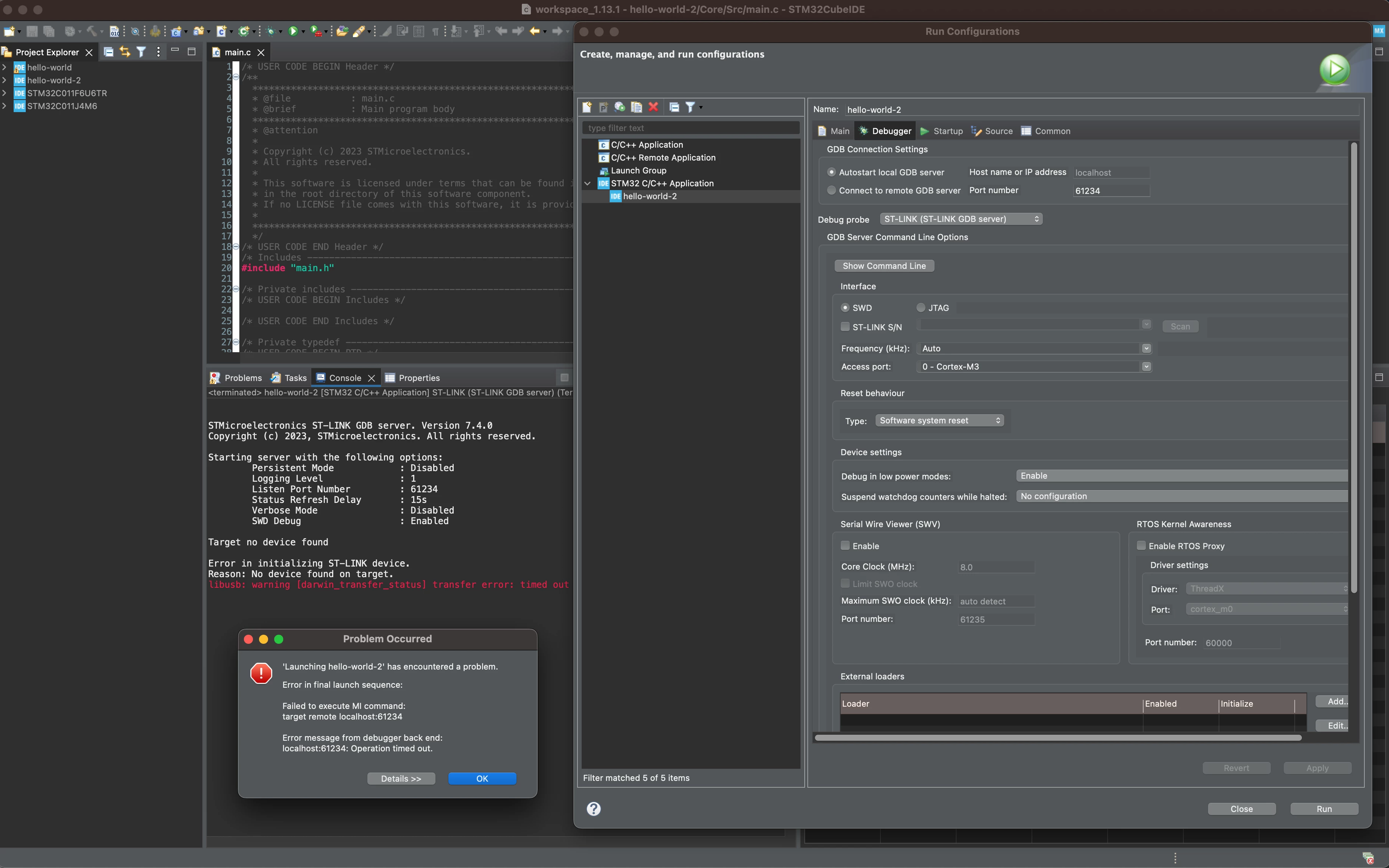

I also have an issue with my STLINK-V3PWR. When I want to run a project using SWD within STM32CubeIDE, it gives the following error:
Error in initializing ST-LINK device.
Reason: No device found on target.
libusb: warning [darwin_transfer_status] transfer error: timed out
When the STLINK-V3PWR is not connected at all, it does indicate that there is no ST-LINK.
w/o STLINK-V3PWR connectedw/o STLINK-V3PWR connected
STM32CubeIDE errorSTM32CubeIDE error
To check if the wiring was wrong, I've checked all the signals on the DEBUG port using my digital analyser. It seems that there is no activity at all. DEBUG pins 7 (GND) and 11 (GNDDetect) are connected through a 100k resistor. Channel 7 is from AUX.

And it is detected with serial in STM32CubeIDE
STLINK detected with serialSTLINK detected with serial
