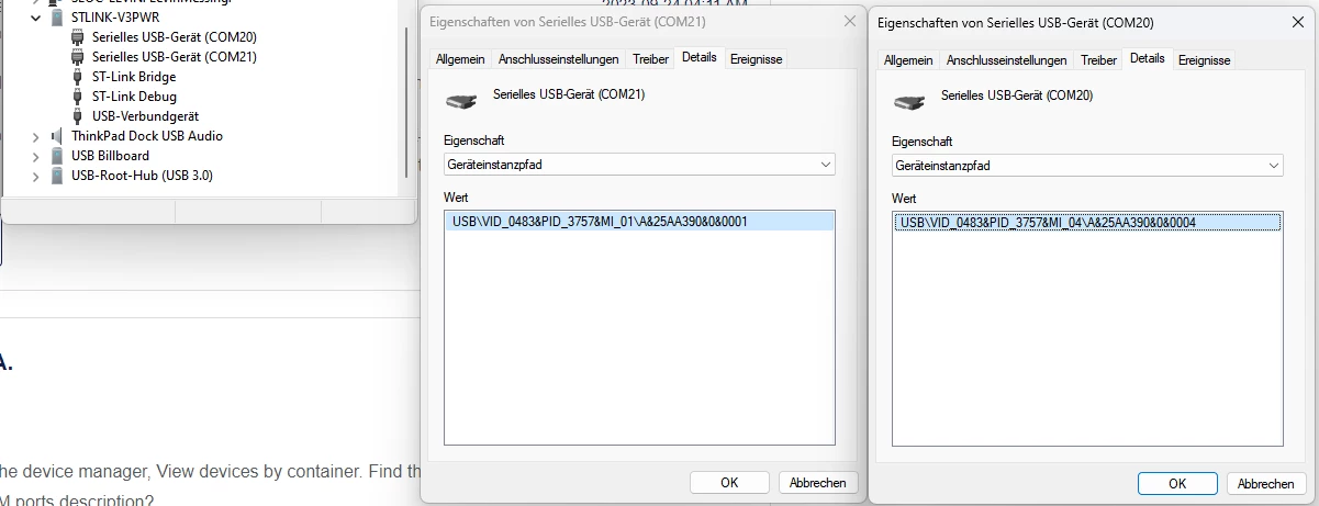

I am struggling to find a good way to identify the two COM ports the STLink-V3PWR provides. One is for direct communication with the power measurement unit and the other is connected to DEBUG for the target device(VCP).
We need a easy way to identify the DEBUG UART port of the STLink-V3PWR. When performing the "-l uart" command with the STM32_Programmer_CLI.exe we receive two identical outputs for both ports. This is not the case with the STLINK-V3SET, because we get an easy identifyable description "STMicroelectronics STLink Virtual COM Port".
In the example below, how do I distinguish between COM20 and COM21? There must be a better way than opening both ports and checking which one responds to the "version" command.

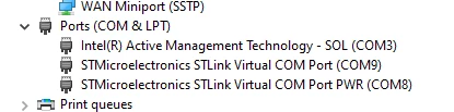

On windows you may install last STSW-LINK009 driver (v2.0.2)  to differentiate the 2 COM ports.
A driver must be installed before connecting an ST-LINK/V2 or an ST-LINK/V2-1 board with a Windows® 10 or
Windows® 11 PC via the USB. This installation is not mandatory for the STLINK-V3 or STLINK-V3PWR boards, but allocates an ST-specific name to the ST-LINK COM ports in the system device manager. The driver is
automatically installed by the toolsets supporting ST-LINK. It is also available from the STSW-LINK009 dedicated
page at the STMicroelectronics website.https://www.st.com/en/development-tools/stsw-link009.html.
Attached the screen shot of device manager before and after STSW-LINK009 installation.

Pavel A.
September 24, 2023
Please check also the device manager, View devices by container. Find the STLINK-V3PWR. Is there any difference in its COM ports description?
In the properties of COM ports, please find Details tab. What are "Device Instance Path" of the COM ports?
lmessing
lmessingAuthor
September 25, 2023
The difference of the "Device Instance Path" is very minimal. The "Description" value is the same.
Pavel A.
September 25, 2023
@lmessing The difference is small but precious. The composite function indexes are all we need to know. One is MI_01 and the other MI_04. This can be used to distinguish the COM ports.
Unfortunately this ST-LINK does not have a "serial number" (strange). This makes parsing the string harder (TL;DR Microsoft warned more than once against attempts to parse these strings - but they don't offer anything much better...)

lmessing
lmessingAuthor
September 26, 2023
Installing the driver fixes this issue, thank you!
-l uart shows now a good description as well:
Board Name : STLINK-V3PWR
ST-LINK SN: 002300433432511839383236
Port: COM20
Location: \\.\COM20
Description: STMicroelectronics STLink Virtual COM Port PWR
Manufacturer: STMicroelectronics
Port: COM21
Location: \\.\COM21
Would be great if this driver was installed automatically when installing STM32CubeMonitor-Power or STM32CubeProgrammer.
