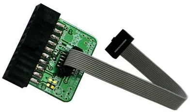

I finally got around to using my STLINK-V3PWR or trying. The issue is lack of thought on STM side, one simple adapter like all those ARM adapters but with a 10 pin 1.27mm pitch connector instead of the 2.0mm pitch they have. I purchased the V3PWR since it has a type C connector instead of the micro USB connector and all the power stuff my standalone power board does but with a case. I think I'll have to make a cable, after hunting for several hours I see no solutions. I had one of these https://bit.ly/4g6lPst laying around, with some soldering and crimping it's a start. A real solution would be a bundle like this https://bit.ly/3D9dA0l with a 1.27mm pitch 10 pin instead of the 2mm pitch 10 pin connector.

Just a simple pinout adaptor.
eg, something like this will get you from 1.27mm to 0.1" (2.54mm):
https://www.mouser.co.uk/ProductDetail/Aries-Electronics/LCQT-MSOP10

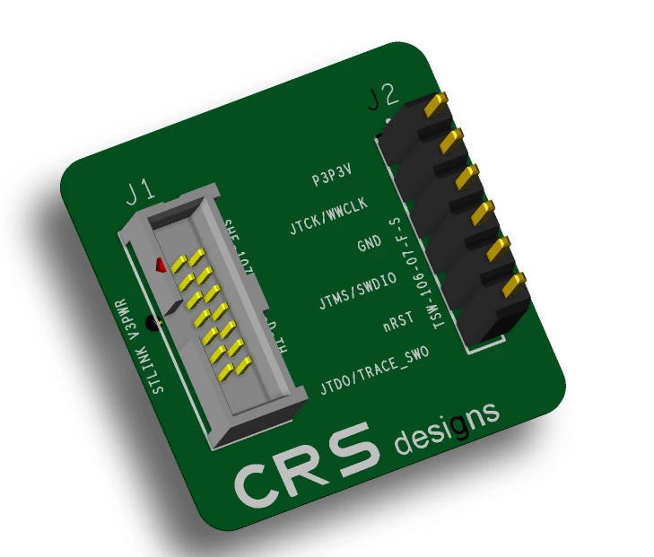

Clyde_SAuthor
Dec 9, 2024 3:27 PM UTC
I have older target boards with a 6-pin header for the ST-Link.  They are 0.025 inches square and on 0.1 inch centers.  This would connect up directly to the ST-Link provided by Nucleo boards.
This new debugger seems to only support 1.27 mm pins on 1.27 mm pitch with the supplied connector.

Clyde_SAuthor
Jan 6, 2025 6:05 PM UTC
So, I made one...
Seems like it should have been included in the box.
