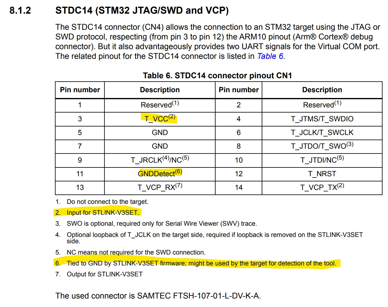

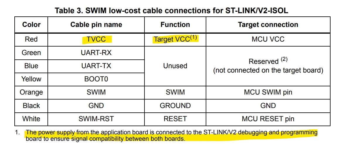

You can read about T_VCC on other ST-link user manuals. It serves the same function here.
Probably GND_Detect is on other programmers as well. Yes, here is both of them in a little more detail.

1. What is GNDDET (Pin 5 of the "32-pin edge connector")? There is no description of this in the publicly released ST documents. Search of the internet says it is a ground detection pin but sources disagree as to whether it is for the STLINK to detect GND of the target or for the target to detect GND of the STLINK. I need to know if it should be connected on my board, but would also like to know its intended purpose.
It's an output from STLINK, so it is for you board to be able to detect the debugger. Pin will be tied to GND with debugger attached.

2. What is T_VCC (Pin 30 of the "32-pin edge connector")? I've seen on the forums that it can be connected to my VCC so the STLINK can sense the voltage of my VCC but again, nothing in the official ST documentation.
It's an input. It allows STLINK to sense the voltage on your chip. You should connect it.

4. The primary use of this device is to allow in circuit flashing of my MCU over SWD. I've connected the GNDs between the STLINK and my MCU GND, SWDIO, SWCLK and the T_NRST to my MCU. Is there anything else that needs to be connected in order to facilitate flashing of code?
Required, no, but T_VCC can be helpful in order to assess the voltage on the board.
