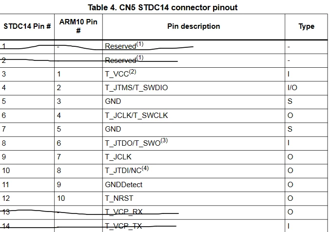

MIPI10 connector using CN5 pins 3..12 should be compatible with MIPI10 on V3SET.

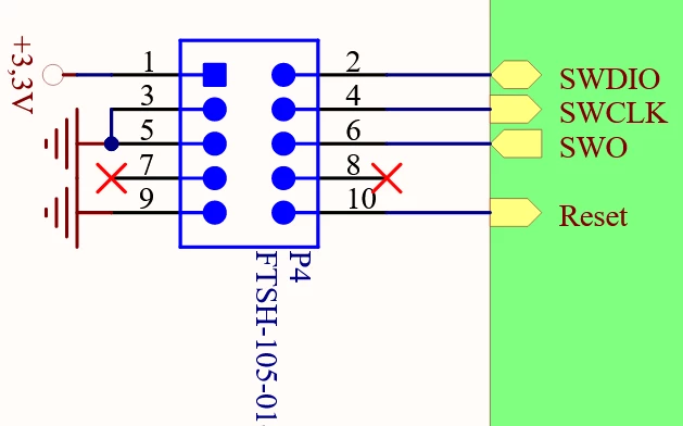

Pins on our board look like follw:

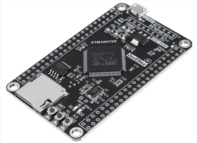

I have STLINK-V3MODS connected  to a H743 board - works fine (since > 1 year).
I just soldered some wires to the edge connector .

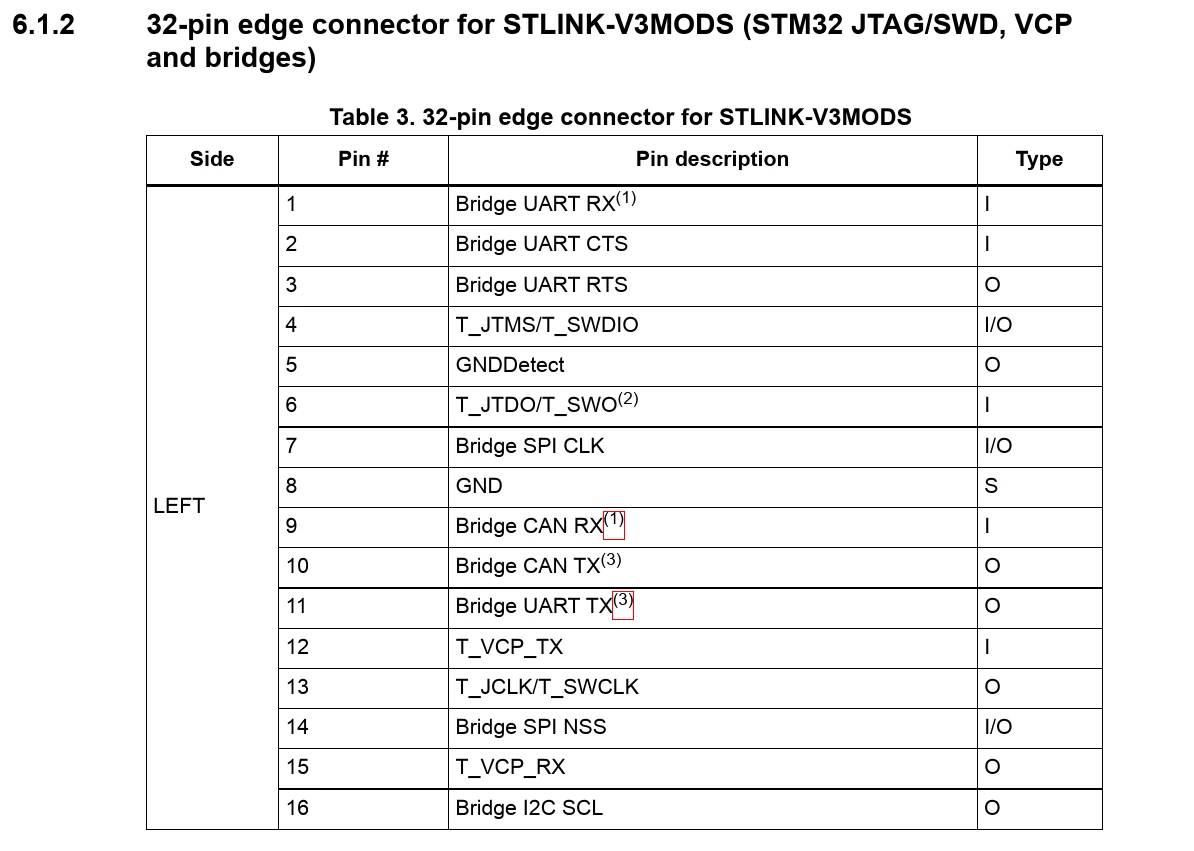

Where did you connect it ?  (MIPI connector not connected on v3mods !)

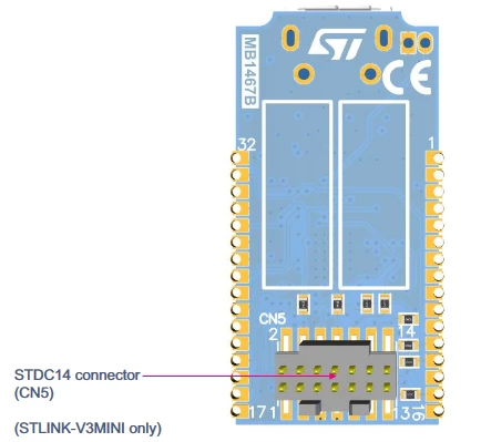

My debuger is MB1467B and looks like V3MINI but it is detected as V3MODS:
Log from CubeProgrammer:
 10:52:22 : STM32CubeProgrammer API v2.14.0 | Windows-64Bits
 10:53:18 : UR connection mode is defined with the HWrst reset mode
 10:53:18 : ST-LINK SN : 001B00174D4B500A20373831
 10:53:18 : ST-LINK FW : V3J13M4B5S1
 10:53:18 : Board : STLINK-V3MODS
Bottom side of my debugger is equpiied with CN5 connector:

My board is as in ds , no cn5 - just the (not full) connected pads ;
cubeProg:
So check : are all pins of this cn5 connected to the edge connector ?
