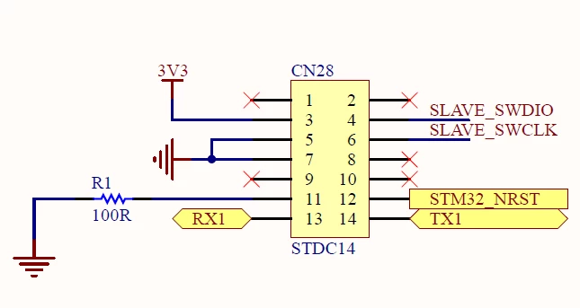

Should be a fairly easy one, but wanted to ask first: the built in T_VCP_RX and T_VCP_TX show the opposite logic input/output to what I'd expect (Rx shows as an output) in table 6 of the user manual UM2502. So would I connect my target Rx pin to the T_VCP_RX on the header? Does the "T_" indicated this is in reference to the target device?

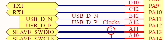

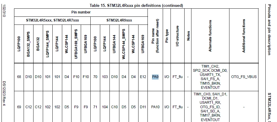

I'm using STM32L4R5 which USART can swap RX/RX. Unless (boot) is needed, it's less of a worry. SPI naming rule is much better (MISO/MOSI) to avoid confusion.
I have a board working, here is the extract info for reference:
Which TX1/RX1 are :
Which correspond to :
I guess with these info, the question is answered :grinning_face_with_sweat:
Yes, USART1_RX or whatever.
Yes
