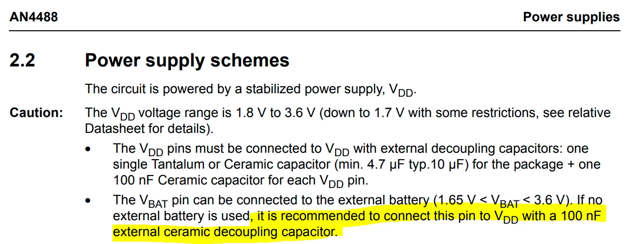

Is it required that I connect VBAT to VDD?
SBrid
SBridAuthor
March 6, 2022
Thank you! The problem was with the vref pin not being connected!!!​
March 6, 2022
Not required, but recommended.
Also see STM32F4 design guide here:
https://www.st.com/resource/en/application_note/an4488-getting-started-with-stm32f4xxxx-mcu-hardware-development-stmicroelectronics.pdf
