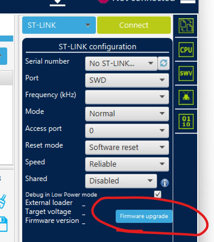

Hi @phil_spobu
Given the symptoms and error logs, the USB interface hardware in the STLINK V3 is probably faulty.
  1. Check the PCB around the USB connector for cracked solder joints or lifted pads. If possible, gently reflow the USB connector solder joints with a soldering iron to restore good contact.
  2. Upgrade or reflash the STLINK firmware using STM32CubeProgrammer, as firmware corruption can sometimes cause enumeration issues.
  3. If these steps do not resolve the issue, the most practical solution would be to replace the STLINK V3 device.
To give better visibility on the answered topics, please click on "Best answer" on the reply which solved your issue or answered your question.Best regards,FBL
Jul 29, 2025 7:19 AM UTC
Is there any manual for that? Which interface shall be used, where do I get the firmware from?
Jul 29, 2025 1:32 PM UTC
The only way to update firmware is using ST tools. If the programmer can't connect at all, no chance of that happening.
Jul 29, 2025 2:01 PM UTC
OK. I thought I would be able to flash with another ST Link directly over JTAG/ SWD interface. I was wondering, if this is available on one of the connectors.
As USB is not recognized at all I cannot use the standard way of flashing the firmware.
