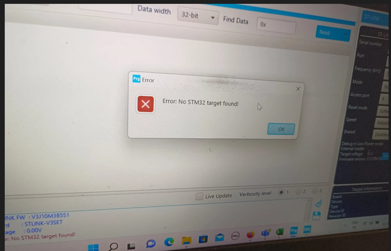

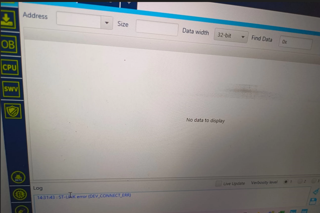

I am working STM32H745 controller. I am trying to connect STLINK_V3 SET to my custom
board. But I getting the errors I am attaching the images ,I set the Debug as serial wire and device is in Connect Under Reset. What things I have to check, also I check the USB cable .Can you please help me.

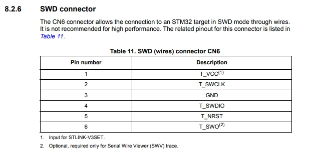

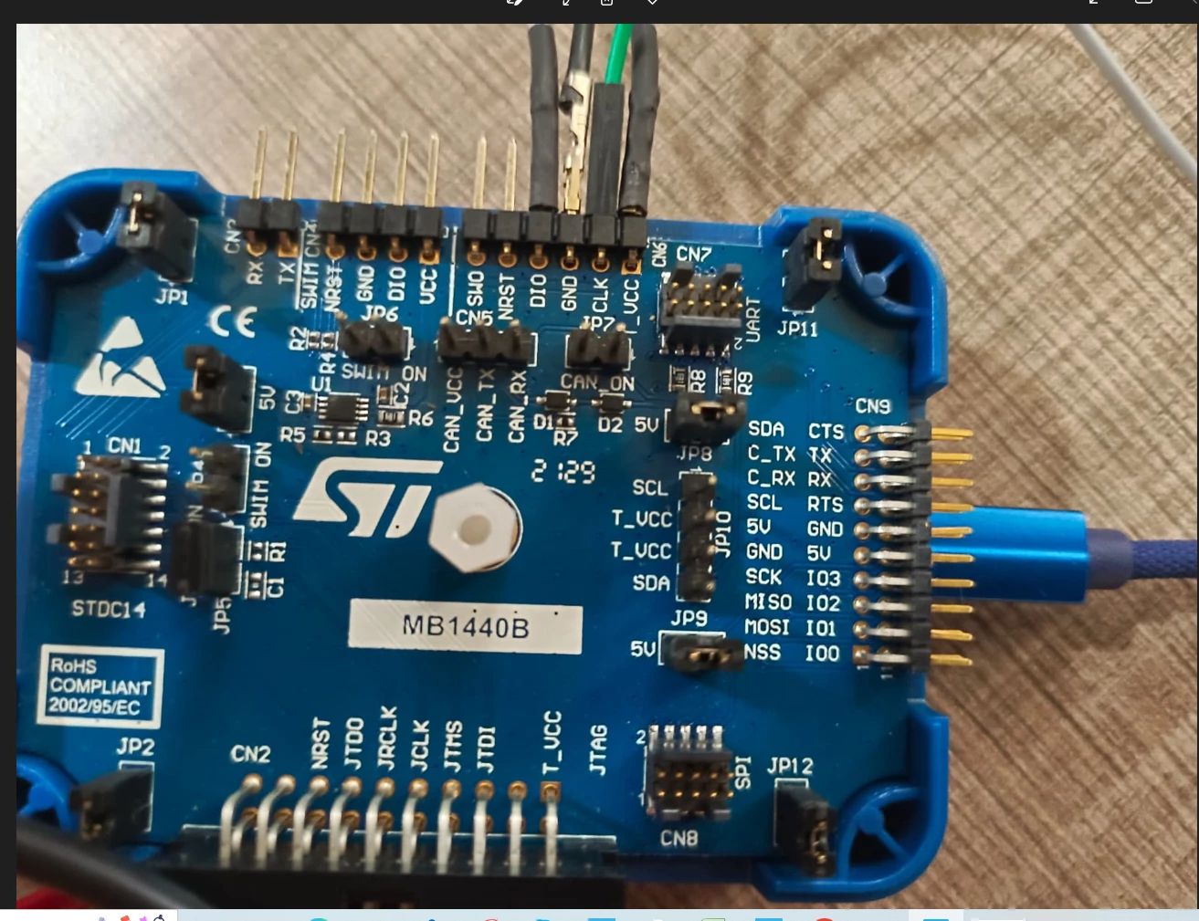

I notice on the second image that your T_NRST is not connected, if you refer to the User Manual UM2448 Rev7 "Section 8.2.6 SWD Connector" these are the required pins for a SWD connection
0693W00000UnDgwQAF.pngFind in attached the document.

Board and chip must be viable and correctl​y connected.
Show schematic section with STM32 pin/power connections.
Check orientation
Check voltage on VCAP and NRST​

October 4, 2022
