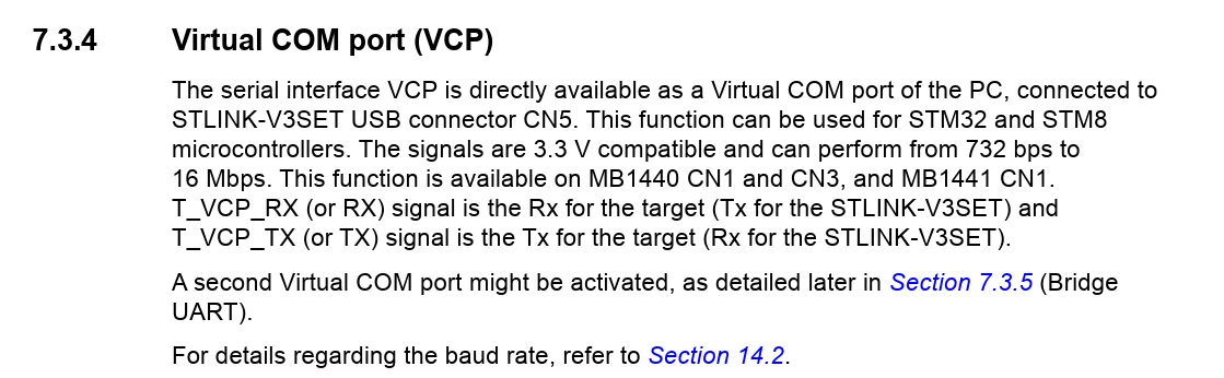

January 24, 2025
This is in the User Manual of  ST-Link V3 Set. This should be clear.
