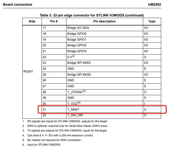

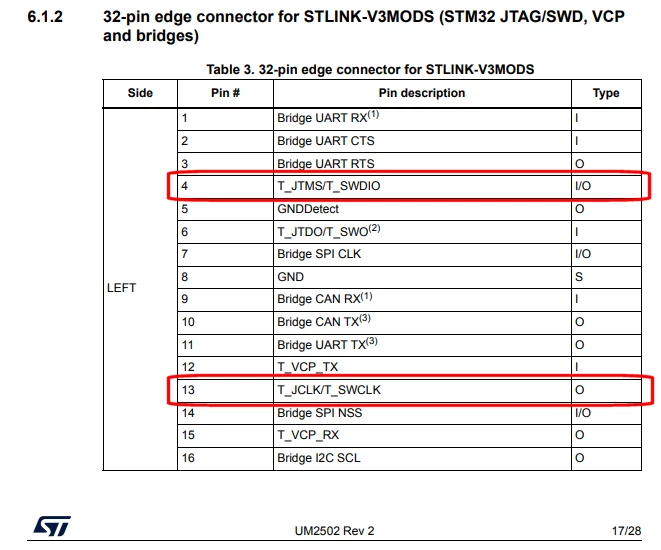

Recently brought 2 pcs STLINk V3 MODS. downloading all the documents from st site i didnot find right information(whre is SWD,SCLK, pin located in STLINK V3 MODS) so that i can connect to my target bare metal board of STM32F103 Series MCU. Very much time wastage buy doing fake stlink v2 , from authentic source i brought STLINK V3 mods in a hope that i can programe and debug. Help required.No fruitfull video, no fruitfull document available throughout of internet.

@BAS-BLEU wrote:
 downloading all the documents from st site i didnot find right information (where is SWD, SCLK, pin located in STLINK V3 MODS) .
It's in the User Manual:
https://www.st.com/resource/en/user_manual/um2502-stlinkv3mods-and-stlinkv3mini-debuggerprogrammer-tiny-probes-for-stm32-microcontrollers-stmicroelectronics.pdf#page=17
via: https://www.st.com/en/development-tools/stlink-v3mods.html#documentation
It is also recommended to connect NRST:
See Section 6.1.3  for the CN5 STDC14 connector pinout;
