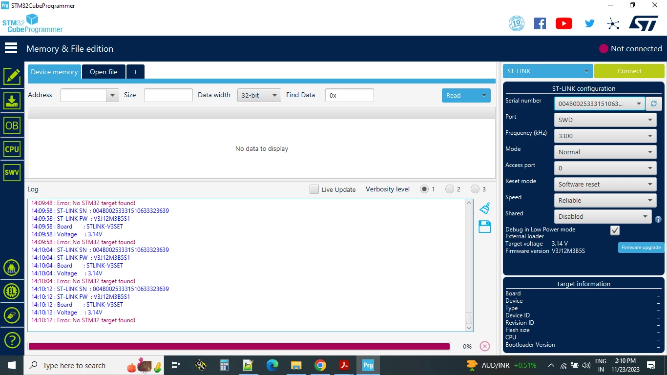

STLINK/V3 debugging problem with STM32 C series.
We are providing power to our Customised Microcontroller (STM#@ C series) board from my power supply@3.3v. we are using STLINK-V3SET with MB1440 adapter, it is an extension board provided by ST.

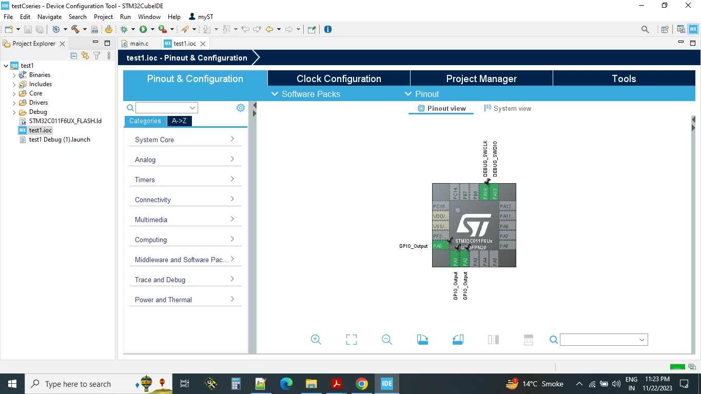

We have connected 3 PINS GND, SWDIO(PA13), SWDCLK(PA14) from CN6(connector 6) of extension MB1440 board. to our microcontroller board.
Getting above error.
NOTE: Clock used is internal & pinout as follows:
a) Is T_Vcc an i/p pin? Do we need to give input 3.3v from my microcontroller board to Debugger connector's CN6 T-VCC pin. When we checked no voltage is present on CN6 T_VCC pin.
(We are powering microcontroller board from external power supply, because 3.3v is not present on STLINK/V3 extension MB1440 board.
b) Do we need to connect NRST pin of CN6 extension MB1440 board to the Microcontroller board . We checked, its remaining high @3.3v on microcontroller board.

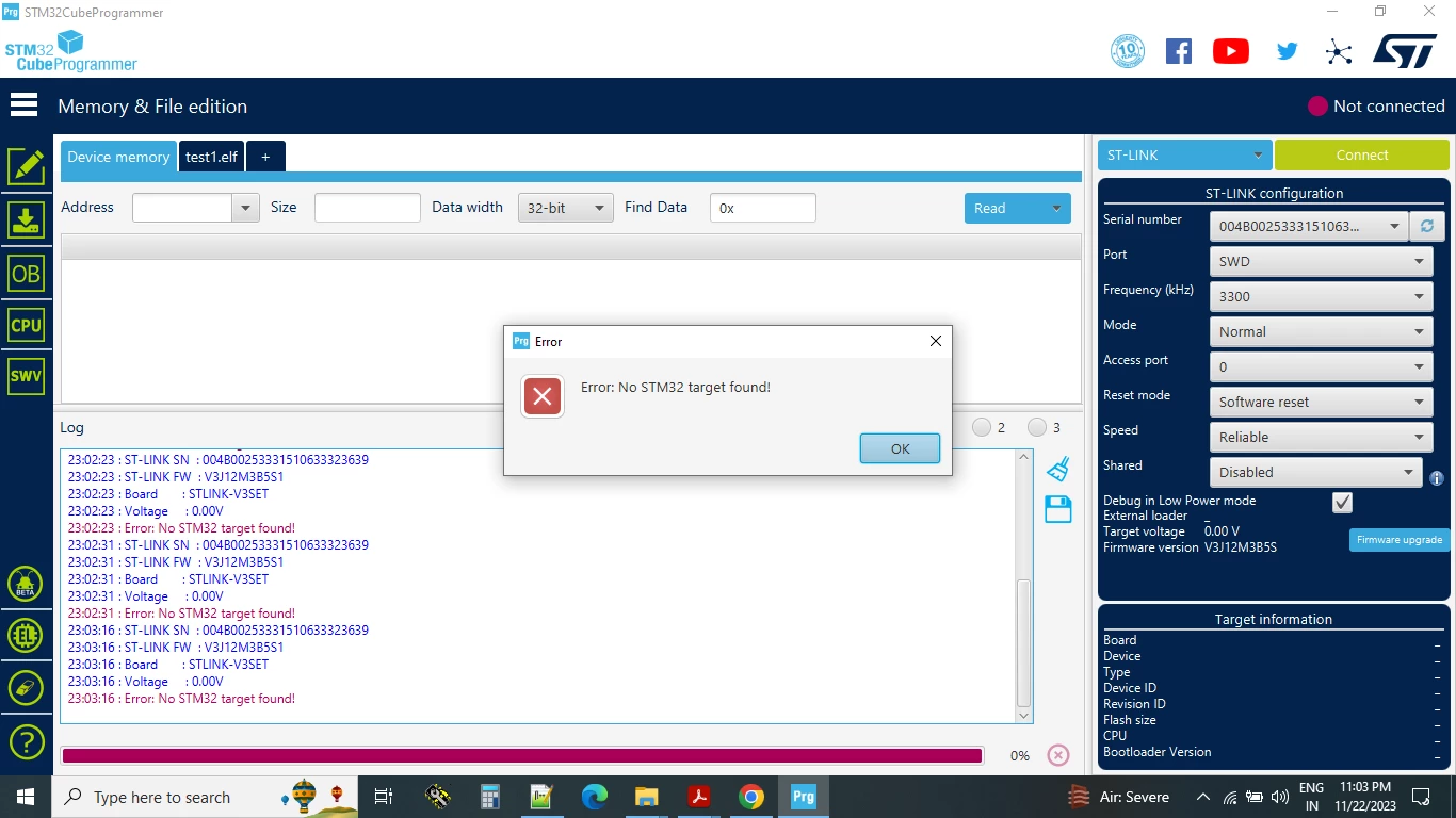

with stlink-V3 you have to connect VDD 3v3 from target to stlink. See : it shows 0,0V at target, refuses to work.
so connect the 3v3 !  (reset is not needed, if you use software reset, as you do. )
November 22, 2023
a) T_VCC is an input to the programmer. It doesn't need connected, but your target does need to be powered. Connecting it lets the programmer verify that power is present.
b) NRST does not need connected, but allows you to connect under reset and it allows the programmer to reset the chip.

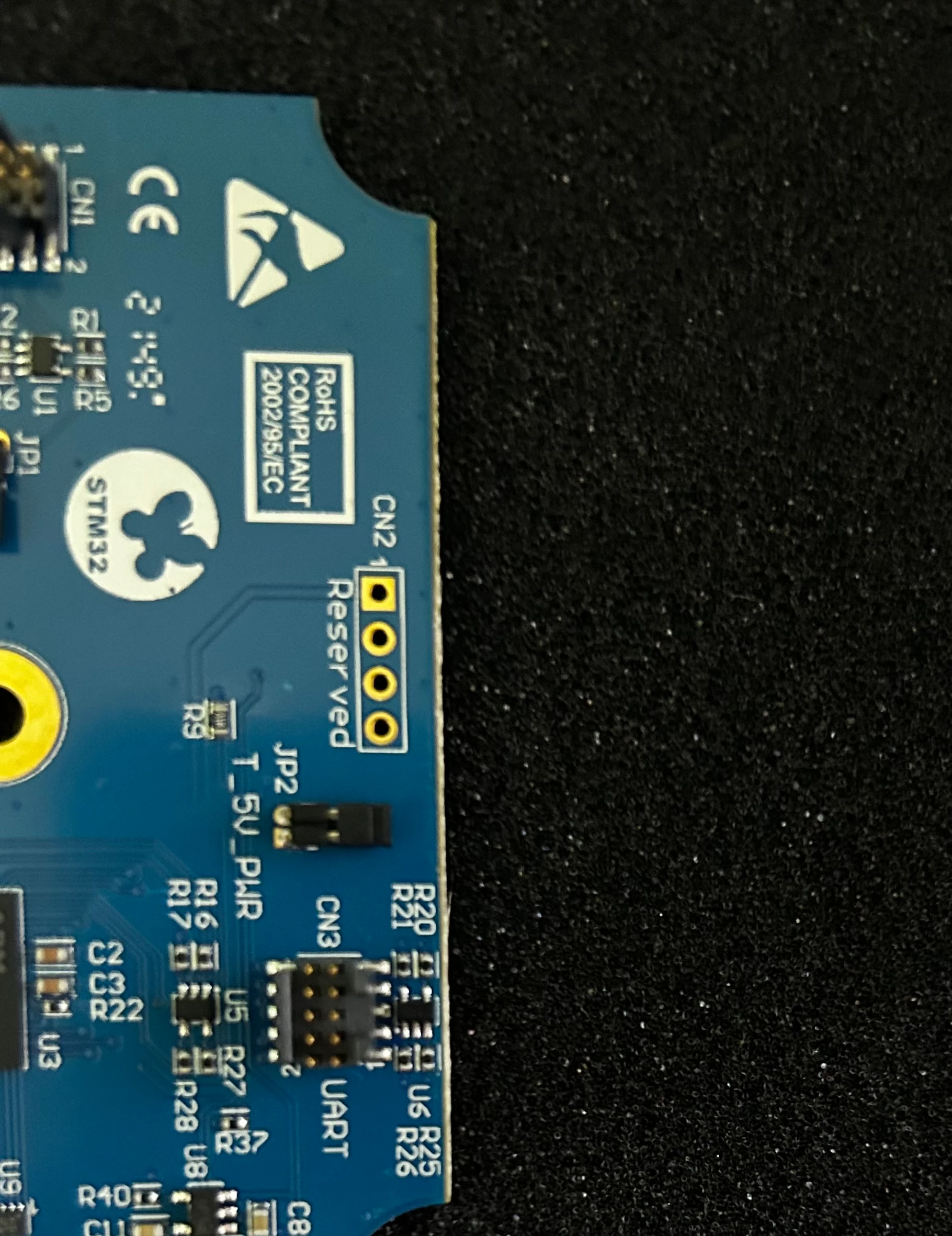

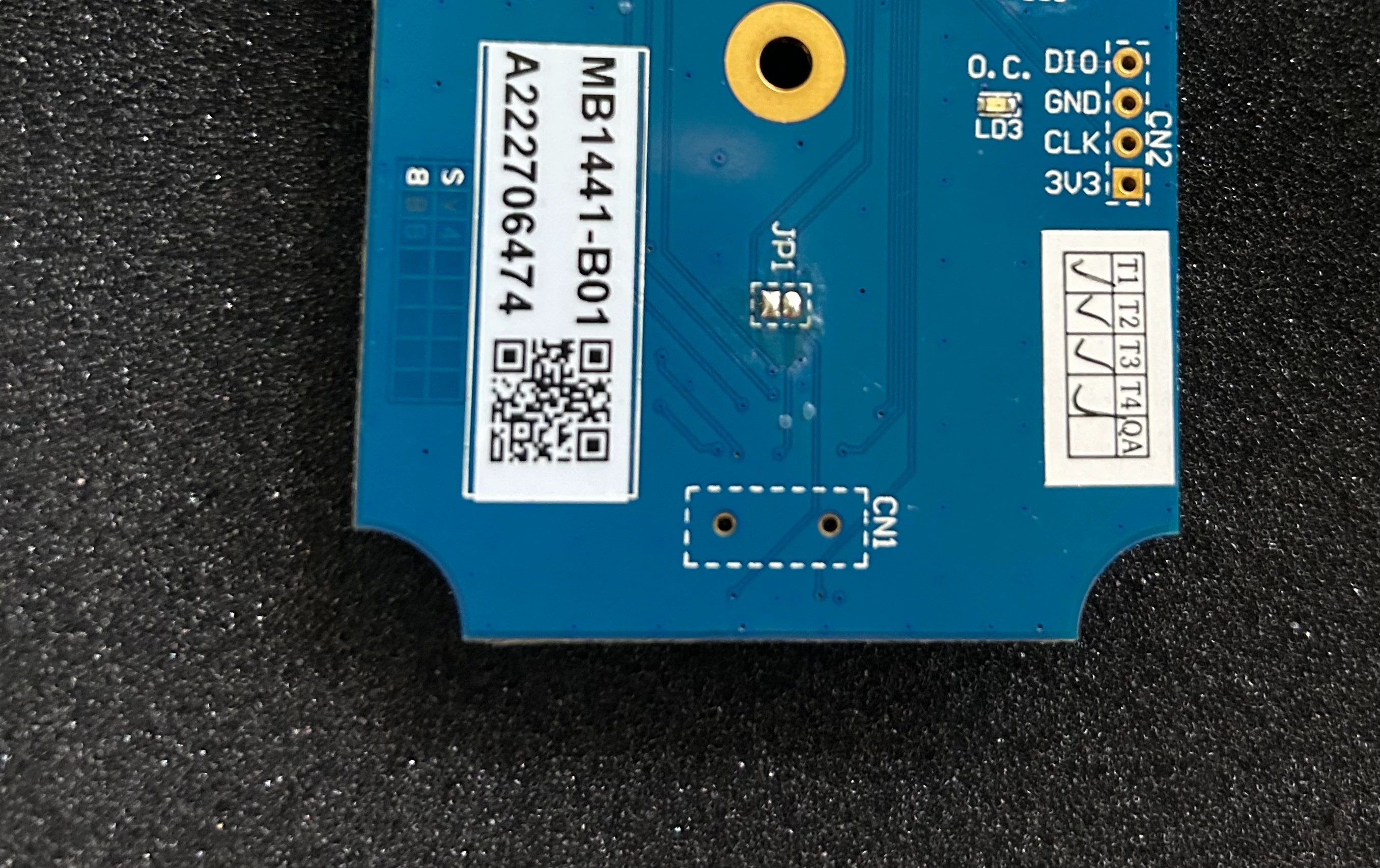

Any idea if i can use RFU connector CN2 from STLINKV3-MB1441 board to power up my microcontroller. 3.3v is available on this connector.
Thanks in Advance.
November 23, 2023
Or is there anyway to power target microcontroller from stlinkv3 debugger?
no.
you wrote: (We are powering microcontroller board from external power supply, because 3.3v is not present on STLINK/V3 extension MB1440 board.
where is this supply now ??
November 23, 2023
Still getting target not found. Any way to check my microcontroller is working fine.
On reset pin getting 3.14v.
Few GPIO's showing 0.2v
Few GPIO's showing 3.14v.
