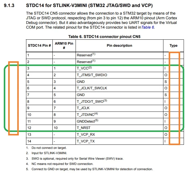

Howdy,
I just purchased an inexpensive STLINK 3.0 Mini, but don't have any convenient way to go from the 14 pin cable, to the fine pitch 10 pin connector on my application board.
Can anyway share a simple solution?
I think the full STLINK 3.0 has a converter cable, I'm wondering if I just have to offset the cable header some way appropriately?
Thanks,
Randy

Yes, annoyingly the Mini only ships with one cable. This I think is an oversight as most available solutions use the 10-pin headering.
The 14-to-10 adaption is just to skip the 2 pins on either side of the center 10 pairings.
ie with the V3SET there is a 10-pin cable, one end crimps a 14-pin header, the other end a 10-pin header.

This means the IDF14 fits an IDF10 directly if there is no tall components around the 10 pin connector.

I use the boxed/shrouded 10-pin headers with the cut-out notch, a lot easier to plug in blind and less prone to operator error.
