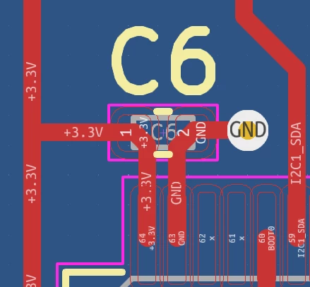

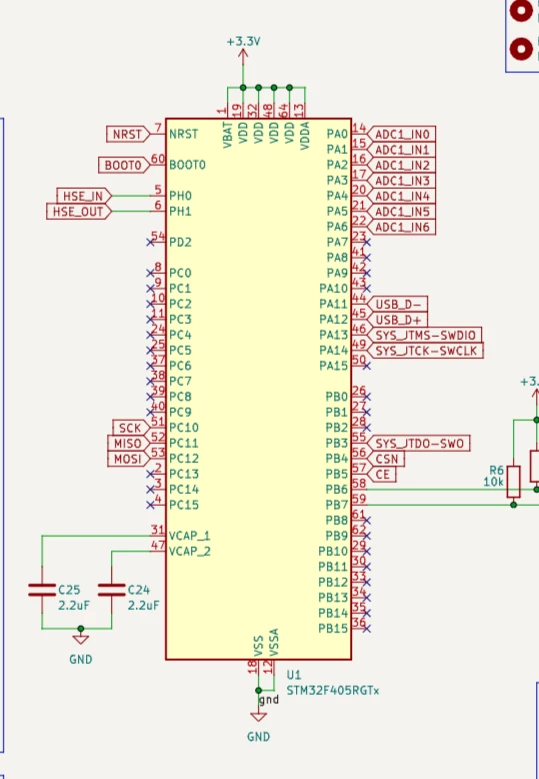

Sep 20, 2023 1:18 PM UTC
Your schematic symbol is missing pin 63 (VSS). If this is left unconnected on the board, it would explain the error.
wv1106Author
Sep 20, 2023 1:28 PM UTC
It indeed doesn't show in the schematic for some reason but it is connected.

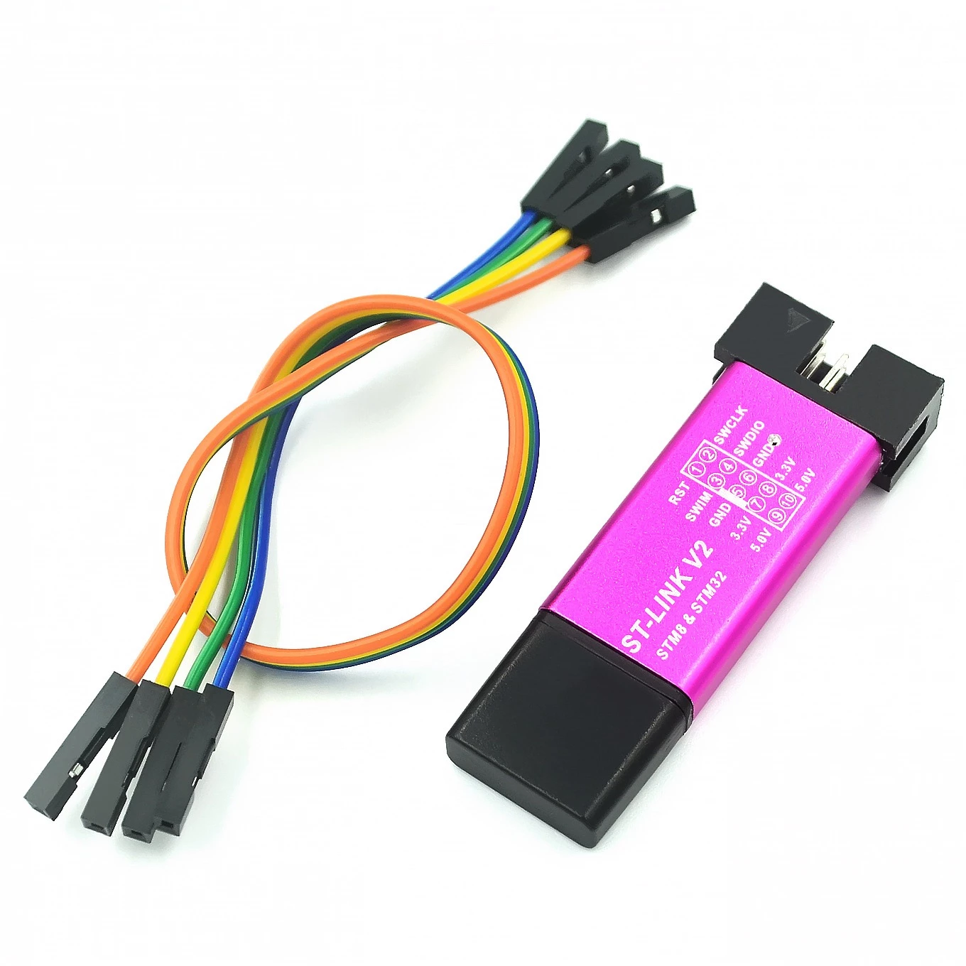

Measure VDD and VCAP to verify correct voltages.
If you have a counterfeit programmer like this, it could also be that the software doesn't like it.
