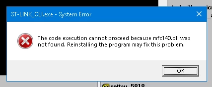

STLink Utility v4.6.0 does not run
It complains about not finding mfc140.dll.
I do have mfc140.dll in C:\Windows\System32.
What next?
[EDIT] The CLI does not run either, throws the same error:

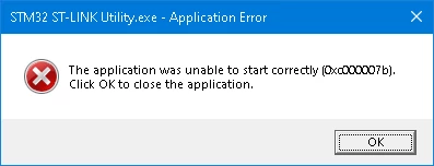

After copying mfc140.dll into the directory where the stlink-utility executable is located (d:\Program Files\STMicroelectronics\STM32 ST-LINK Utility 4.5\ST-LINK Utility\), attempting to run it results in
[EDIT2] You may have noticed that the directory name I mentioned above contains "4.5". That's because running the installator it offered only to rewrite the existing installation, with no further options - which is quite nasty, too.
After uninstalling v4.6 and reinstalling v4.5 (which I wisely archived), v4.5 works.

Probably copying that DLL manually is not enough. Instead install the runtime for Visual Studio 2015:
https://support.microsoft.com/en-us/topic/the-latest-supported-visual-c-downloads-2647da03-1eea-4433-9aff-95f26a218cc0
waclawek.jan
Apr 20, 2021 2:23 PM UTC
As I've said in the second line of my initial post, I already had the VS redistributable installed. And yes, it had been installed from exactly the package you linked to, long ago.
The copying was just an attempt to move things forward.
[EDIT] For good measure I downloaded and run the VS redistributable installer again. No surprise, no change, no work.
[EDIT2] Piranha, so the V4.6.0 STLink Utility does work at your place, right? Did it run right after installation, or did you take any extra steps?

Just in case - you do know that software is 32-bit and you need x86 runtime, not x64 for it? :) Is the OS 64 or 32 bit? Is the path to executable really on a "D:\"? Some software can have some hard-coded paths and that can brake things.
waclawek.jan
Apr 20, 2021 10:37 PM UTC
> Installed right now on W7 x64 - works without any extra steps.
Thanks for trying.
> Just in case - you do know that software is 32-bit and you need x86 runtime, not x64 for it? =)
No, I didn't know that, nor do I know what are the ramifications of this. I'm quite actively trying to avoid understanding the PC world.
Are there two versions (32/64-bit) of mfc140.dll?
Is the v4.5.0 64-bit, then, or how comes that one runs?
W10, 64-bit.
The installer gave me no choice, it simply overwrote the existing - and working - v4.5.0 installation, on D:.
waclawek.jan
Apr 22, 2021 12:12 PM UTC
Okay I got it, on a 64-bit system I need the x86 MSVC redistributable, VC_redist.x86, which installs (among other things) mfc140.dll into C:\Windows\SysWOW64 (it's a different mfc140.dll from that which came with the 64-bit MSVC redistributable and got installed into Windows/System32. Very thoughtful of MS).
